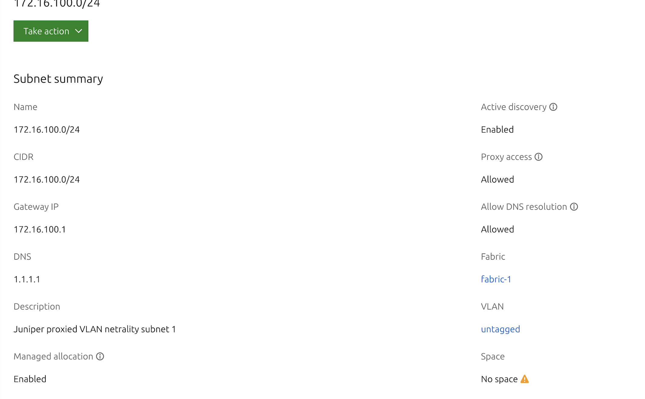

I have maas configured for dhcp but it seems the instances can’t find the llpd package. This smells like a networking issue somehow??
Here you can see my network settings. The .1/32 is my juniper router. The .110/32 is my maas server.
I have it configured as a proxy.
The error is:
" E: Unable to locate package lldpd "
