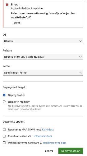

maas 3.6.2 - Failed to retrieve curtin config: 'NoneType' object has no attribute 'url'
This env is airgapped and the node is commissioned and ready but when I try to deploy the image that commissioned with ubuntu 24.04 or to use a custom image created on packer-maas I get this error: “Failed to retrieve curtin config: ‘NoneType’ object has no attribute ‘url’”

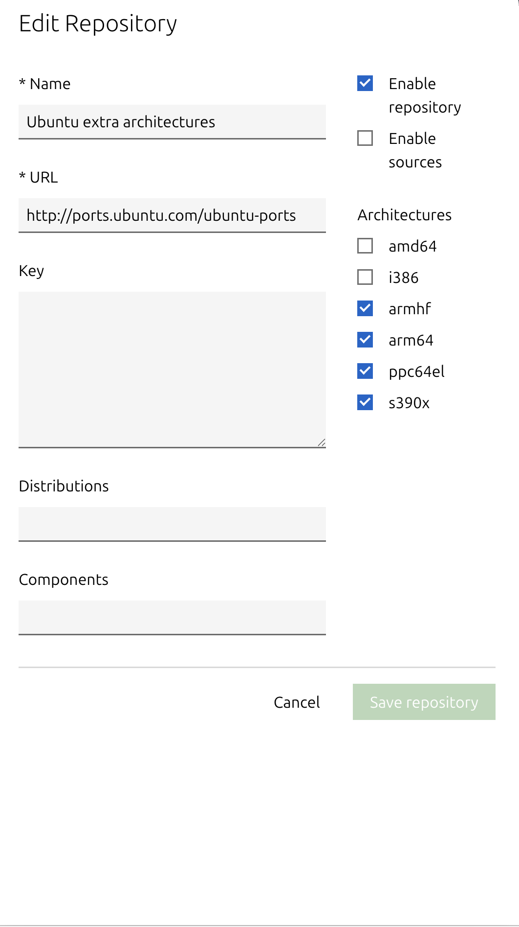

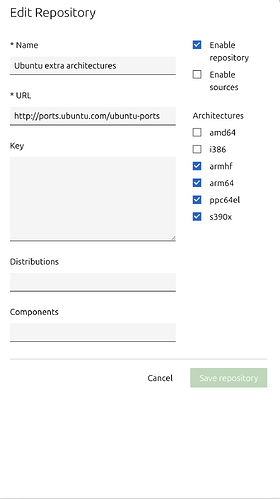

I found a similar case here in the forum that the solution was to put the other arch even if they are not going to be used Bug #1847337 “Failed to retrieve curtin config: 'NoneType' objec...” : Bugs : MAAS but that didn’t solve it for me .

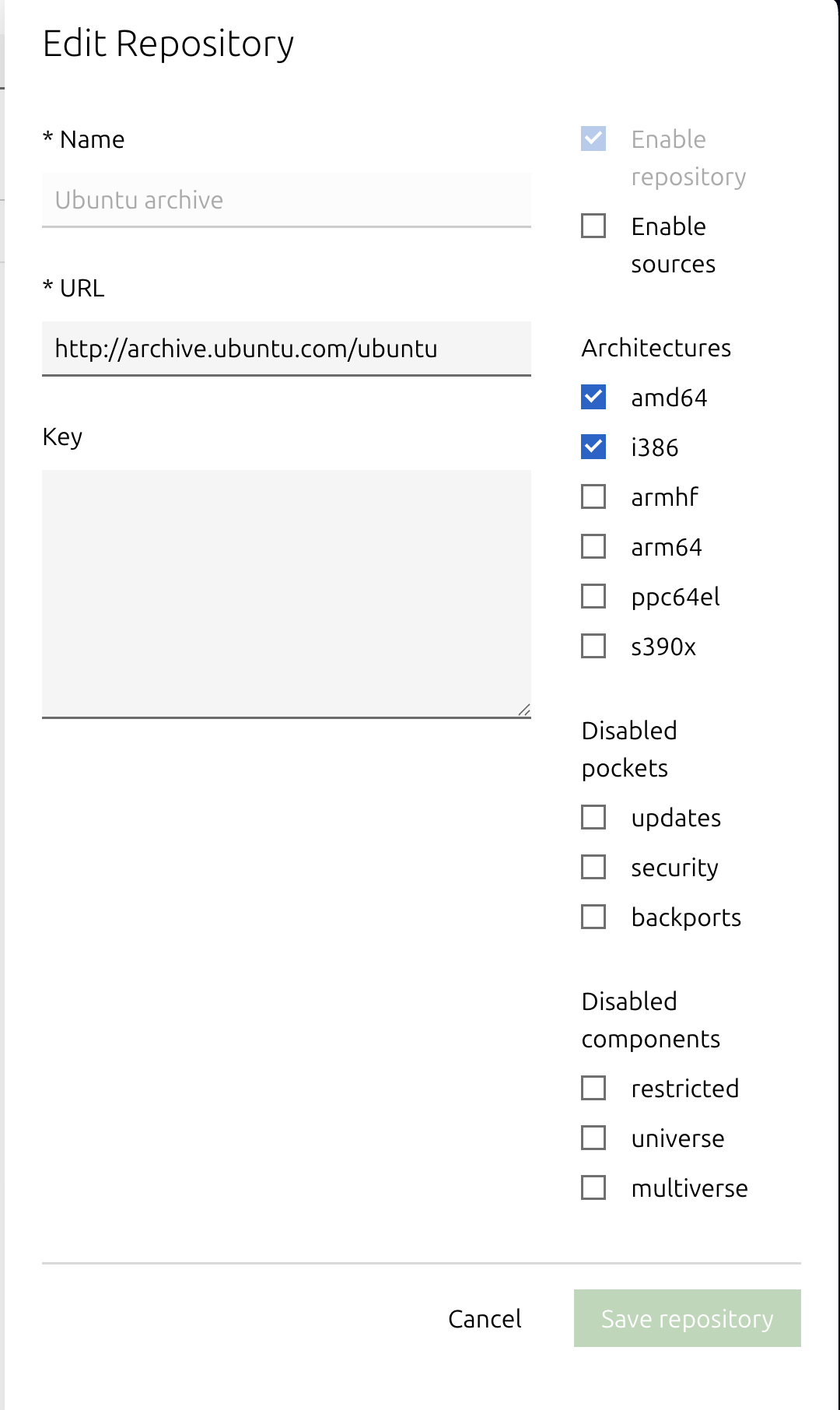

and here below you can see both of my package repos:
and I am using aptly to serve the needed packages to the nodes using dns to resolve back to the local repo.

Dec 20 21:25:45 ag-maas maas-regiond[372950]: maasserver.websockets.handlers.machine: [error] Bulk action (deploy) for 88g77f failed: Failed to retrieve curtin config: ‘NoneType’ object has no attribute ‘url’

Dec 21 20:53:47 ag-maas maas-regiond[372953]: maasserver.websockets.handlers.machine: [error] Bulk action (deploy) for 88g77f failed: Failed to retrieve curtin config: 'NoneType' object has no attribute 'url'
it only shows that it cannot find the url type although it does exist when I inspect the images.

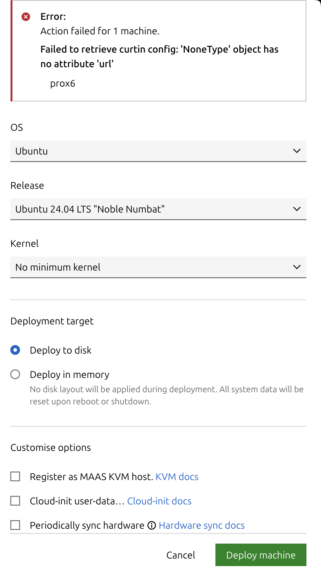

Dec 21 22:57:06 ag-maas maas-regiond[372950]: maasserver.websockets.handlers.machine: [error] Bulk action (deploy) for 88g77f failed: Failed to retrieve curtin config: ‘NoneType’ object has no attribute ‘url’

Dec 21 22:57:52 ag-maas maas-regiond[372950]: maasserver.websockets.handlers.machine: [error] Bulk action (deploy) for 88g77f failed: Failed to retrieve curtin config: ‘NoneType’ object has no attribute ‘url’

it don’t see any indications on why this is happening here it just stats that there is no url att in NoneType .
If you think this is related to the version I can downgrade/upgrade I don’t mind as long as it works.
