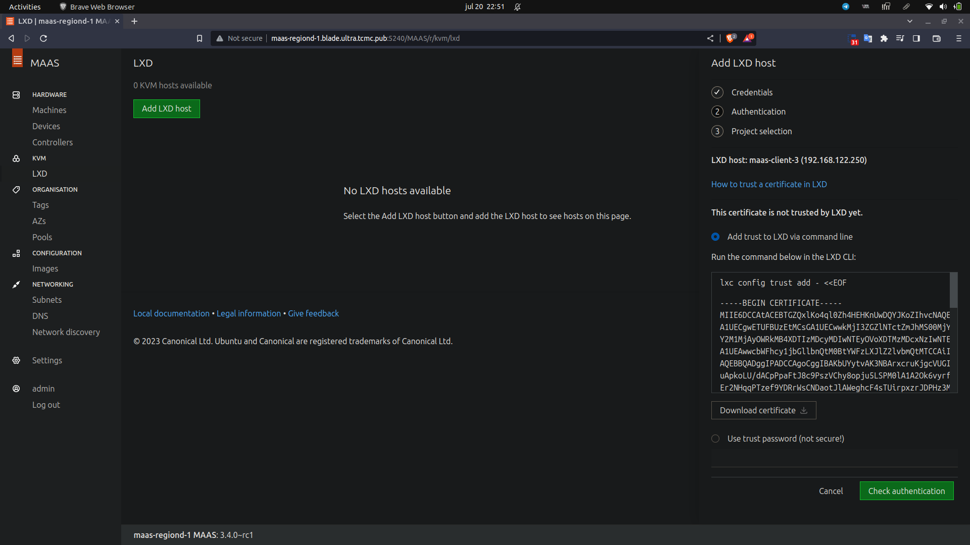

Here are some screenshots for reference:
- LXD Cluster added to MaaS:
- LXD node known to MaaS rebooted intentionally, MaaS losing access to LXD Cluster:
NOTE: MaaS regains access after LXD Node comes back online.
- Another LXD node was added to MaaS to address the SPOF situation:
- Resulting duplicate LXD Cluster listing in MaaS UI:
