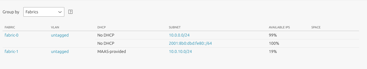

We’ve still not quite managed to get to the root of this issue, I’m not.a bind expert and the generated files ‘look fine to me’ but we are still experiencing issues with dns lookups.
From a default deployment, all we’ve done so far to is to add a DHCP server to the 10.0.10.0/24 subnet.
