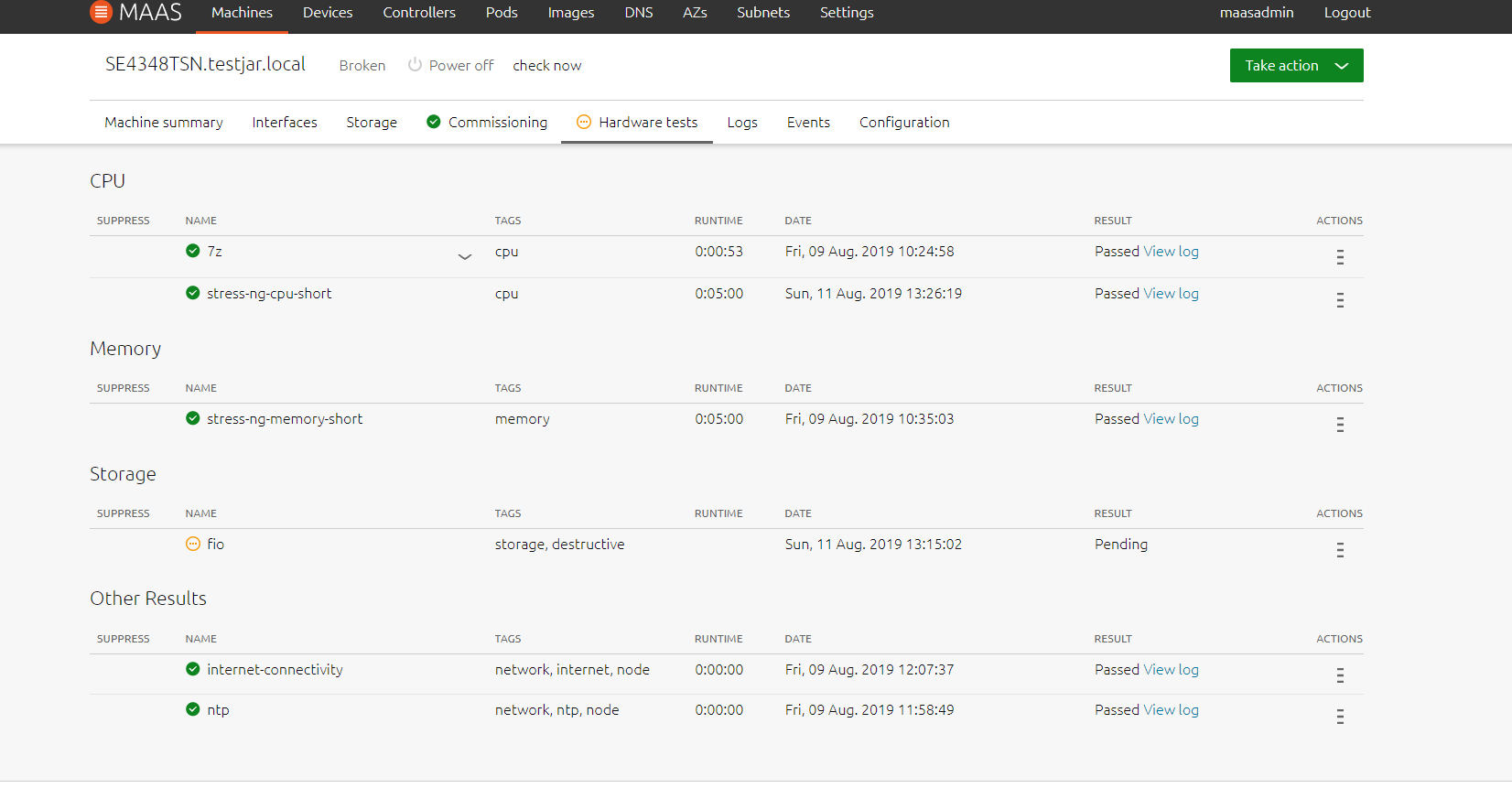

I Log in to the UI. I start the machines, and they are discovered.
Commissioning phase passes and all hardware tests are passing except storage once.
The storage tests are failing, but in the UI it seems like they are pending (anyway that is another issue I guess).

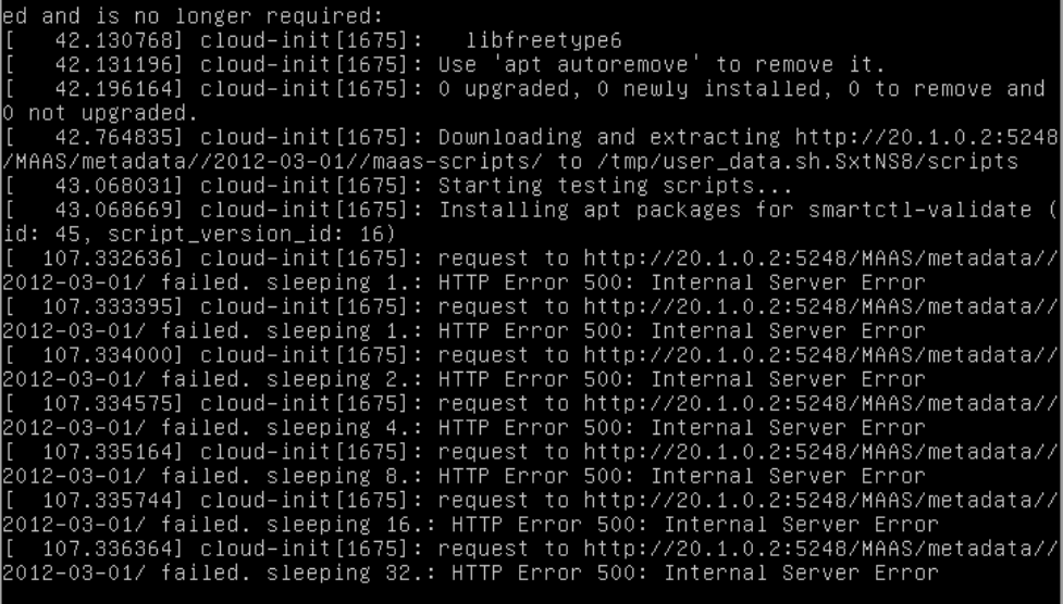

I didn’t find exceptions messages in the UI, I opened the KVM console for the machines, and I saw that:
Fio, smartctl-short, smartctl-validate are failing with HTTP 500.
badblocks is failing with no authorized ssh keys for user
During the install, no ssh keys were imported, that can explain maybe one failure but the other ones …
Can someone help me with this?
Can you post the MAAS logs found in /var/log/maas? According to that error message the machine is unable to signal to MAAS that the test is starting which is what is causing the failure.

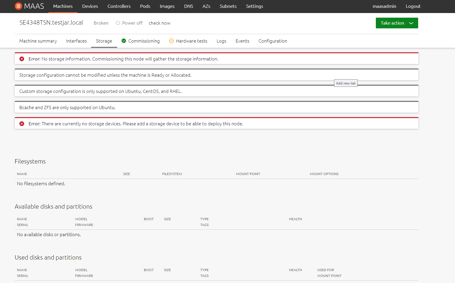

Thanks for the logs. This appears to be a bug in how event are emitted. However I suspect that there may be an issue detecting storage devices.
  1. Are storage devices detected after commissioning runs? You should see devices on the storage tab in the UI?

  1. No, storage is not detected, don’t see it in the UI
Storage devices are Samsung SSDs. All are detected in the ILO (ILO v4, firmware 2.61)

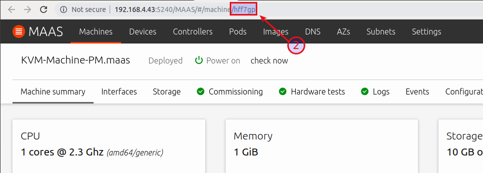

ltrager,
you need to create a cli user by using this below command
Syntax:
maas-region apikey --username= > <key_file_path>
Example:
maas-region apikey --username=admin > /root/admin_apikey
Then Login the cli user by using the below command
Syntax:
maas login - < <key_file_path>
Example:
maas login admin http://192.168.4.43:5240/MAAS/api/2.0/ - < /root/admin_apikey
then you need to run the (maas $PROFILE node-script-result read $SYSTEM_ID current-testing) command
Example:
maas admin node-script-result read hff7gp current-testing
