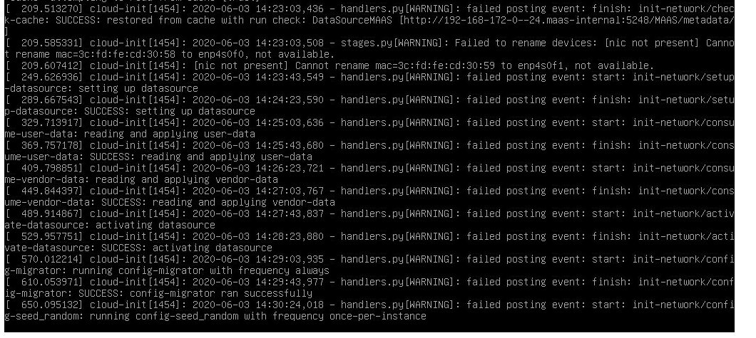

I’m facing this issue again, we had to swap server NIC with a new one because of hardware failure, this NIC is not even the one which is used to join maas, but of course my network configuration is not good anymore because the mac addresses are pinned into my netplan conf. I actually just need to log in and change those, but I can’t.
Once again cloud-init is starting its stuff that takes too much time :
Any tip to skip this please ? This is so annoying.
