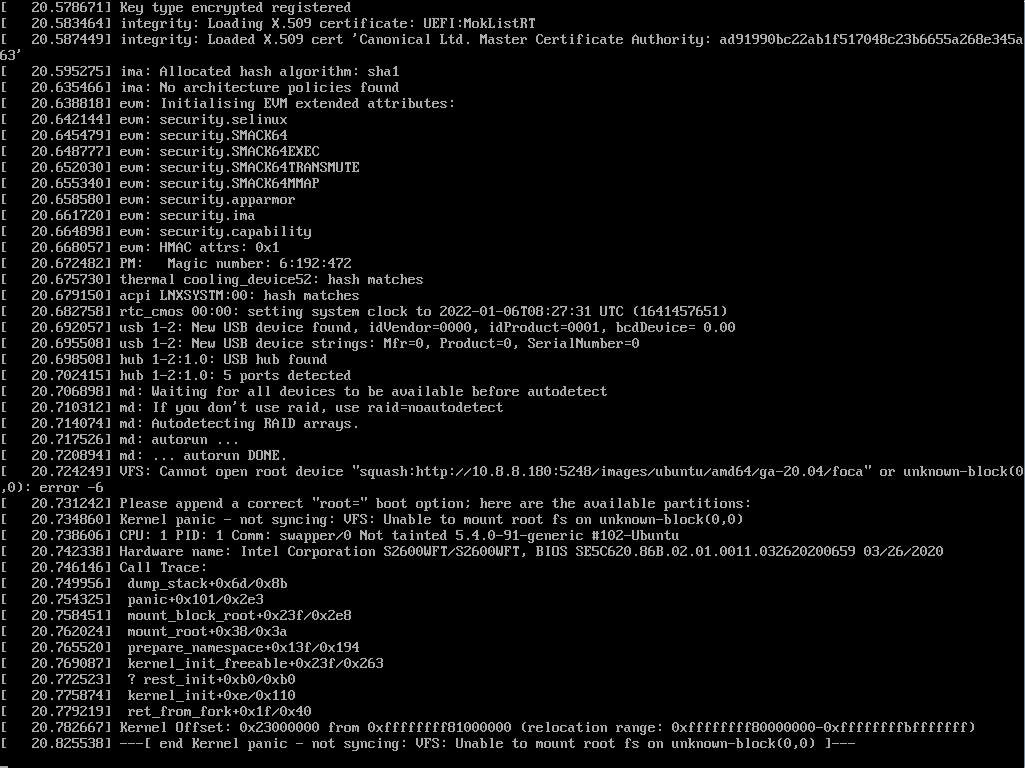

Kernel panic during first PXE boot
What does VFS: Cannot open root device … or unknown-block(0,0): error -6 mean?
All other machines are auto-detected using PXE boot without kernel panic but not this one.
How to debug?
Output from the console during PXE boot of this machine:
Any ideas?
//Bjorn

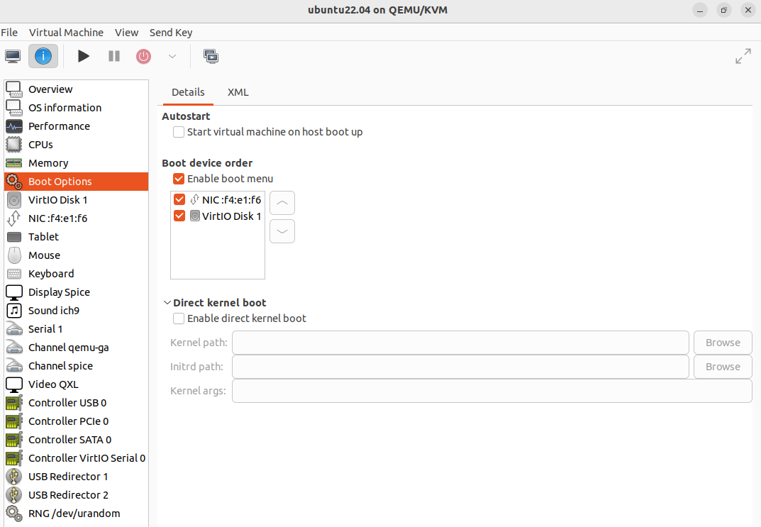

For the posterity, in case you are using virsh and you are hitting this issue please ensure you have enabled VirtIO as boot device as per screenshot
