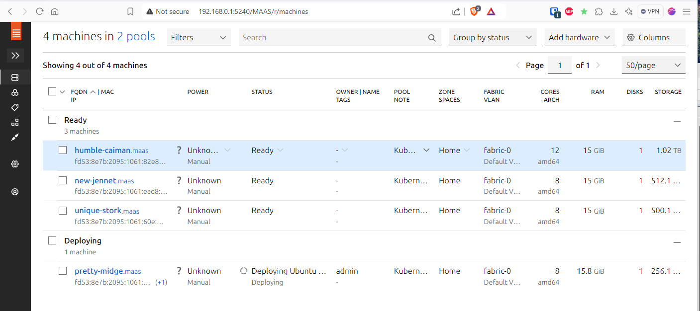

When I did, it seems like Juju is claiming one of my four nodes for some reason leaving only three remaining for deployment.
Anyone know why Juju is claiming one node when I create a MaaS Cloud?

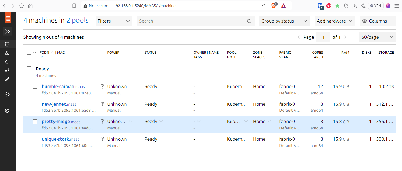

Here is my MAAS cluster after only commissioning four nodes.
I am now going to retry and I will capture my commands and outputs…

ubuntu@juju-a:~$ juju bootstrap home_maas maas-controller --credential home_maas_admin
Creating Juju controller "maas-controller" on home_maas/default
Looking for packaged Juju agent version 3.5.3 for amd64
Located Juju agent version 3.5.3-ubuntu-amd64 at https://streams.canonical.com/juju/tools/agent/3.5.3/juju-3.5.3-linux-amd64.tgz
Launching controller instance(s) on home_maas/default...
 - ec4d68 (arch=amd64 mem=15.8G cores=8)
Installing Juju agent on bootstrap instance
and after the bootstrap completes,
Waiting for address
Attempting to connect to 192.168.1.95:22
Attempting to connect to fd53:8e7b:2095:1061:ead8:d1ff:fe4d:33d2:22
Connected to 192.168.1.95
Running machine configuration script...
Bootstrap agent now started
Contacting Juju controller at 192.168.1.95 to verify accessibility...

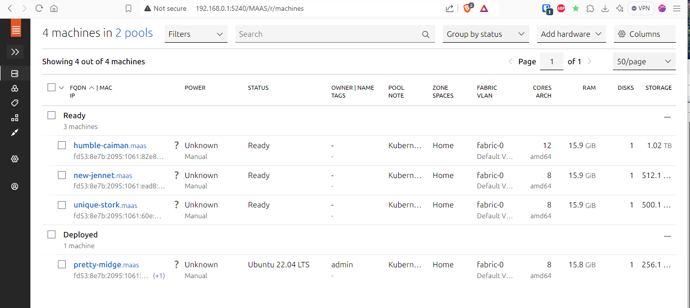

Bootstrap complete, controller "maas-controller" is now available
Controller machines are in the "controller" model
Now you can run
        juju add-model <model-name>
to create a new model to deploy workloads.
ubuntu@juju-a:~$
and one node is consumed.
The node is consumed because juju found a free node to bootstrap itself to.
