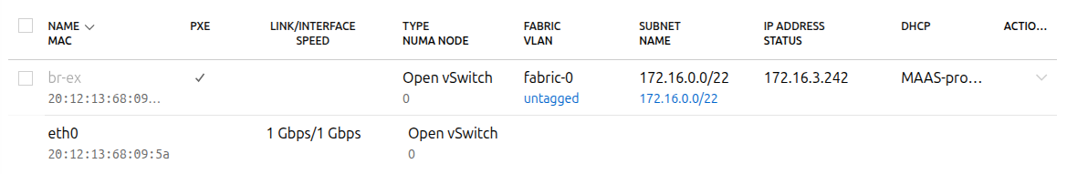

I’m facing an issue when deploying a machine using MAAS with a bridge configured.
When I select the option to create a bridge (as shown in the attached screenshot), the machine is successfully deployed — networking is configured correctly and I can ping the host. However, SSH access does not work, and cloud-init does not finish the customization process.
I’ve tested directly from the console and verified that the network is up and functional. Still, something along the way seems to prevent cloud-init init from running or completing its tasks.
After a long time, the machine ends up with a “Deployment failed” status in MAAS.
This is how I configured the bridge:
MaaS Version: 3.5.6
OS Version: Ubuntu 22.04 from maas
Any advice or suggestions on what might be missing?
