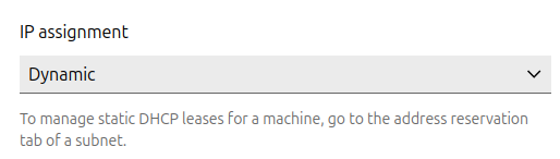

It seems this did indeed get merged and released in MAAS, so here’s the fix:
For anyone wondering how to solve this problem of Intel AMT losing the Power driver connection after deploy. This happens because the IP changes in the Deploy phase.
You can fix this by setting “IP assignment” to “Dynamic”. This will force the device to keep using the same IP as during the “commission” phase, even after deploy.
