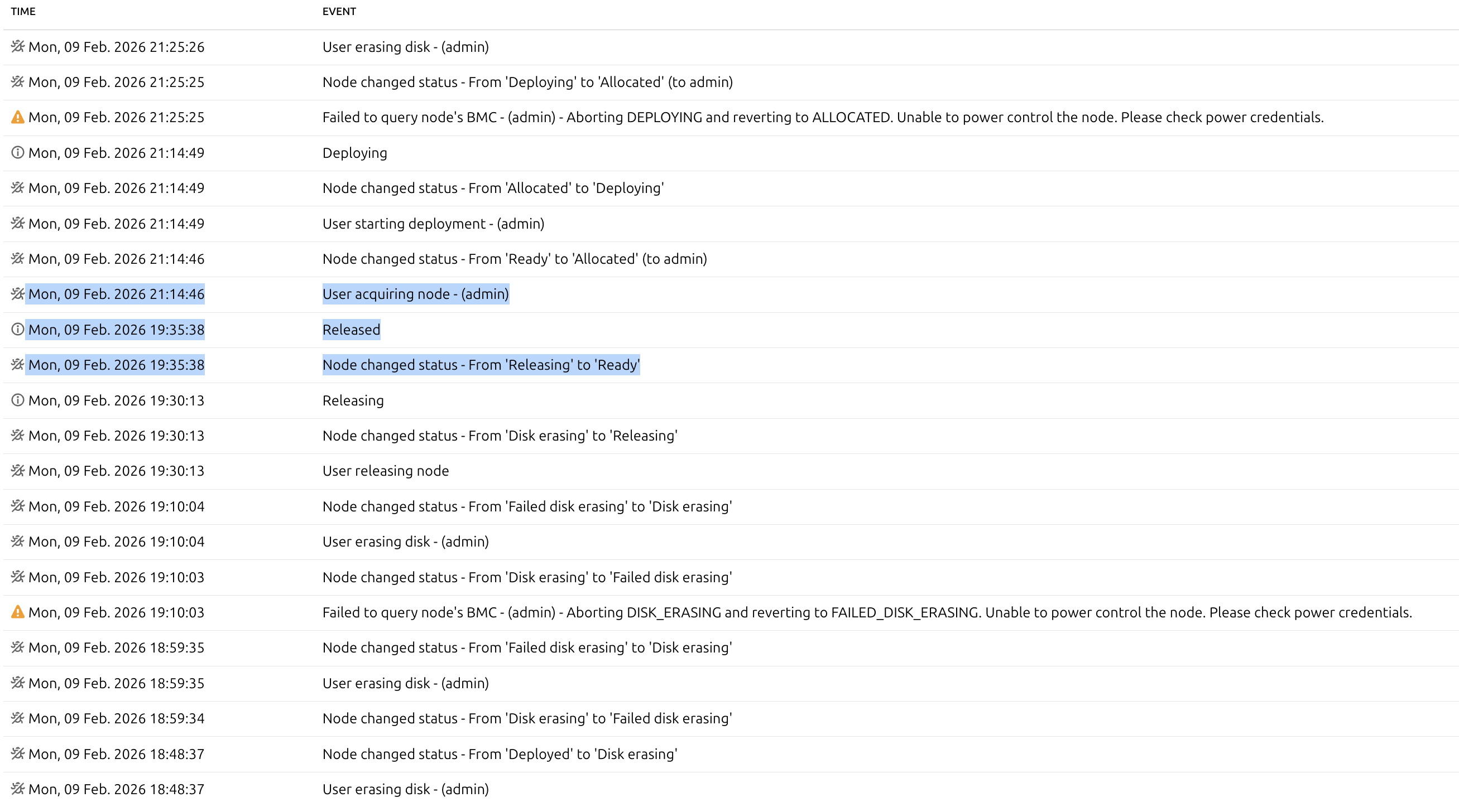

Something that I noticed for one of our machine is, after some unsuccessful Disk erase attempts on a machine, it was transitioned to RELEASE and eventually READY. This made the IP address of the machine to be added back to pool, and eventually getting used up by a fresh machine that was selected to be deployed by CAPI. This created IP duplication leading to chaos. Attaching a snapshot of events.
We run MaaS 3.5.8 on Jammy, and we have enable_disk_erasing_on_release and disk_erase_with_secure_erase both set to true. So, ideally any release attempt should go through a Disk erase cycle before moving to Ready. I am not sure if this is some kind of known bug. Trying to find the root cause, to prevent such issues in the future.
