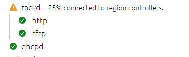

              The network interfaces never seem to update. If I install the Snap with the IP address not already on the interface I want to use for node discovery with MAAS managed DHCP, then I have not found a way to get the Controller to detect that IP after the fact.
most of the time some rackd services go down and never come back up even after reboot.
Last week had rackd, httpd, tftpd and dhcpd go down and was never able to get them back up. Had to snap remove maas and mass-test-db and re-install the whole thing. Even just purging the DB and re-installing mass-test-db with a re-init region+rack came back with the services still dead.
Is there a link between database content and actual service status and availability? I mean can a database corruption or badly written data, actually make the services go down and be unable to come back up? Could it be that I am using the Snap DB that is causing instability? I would really doubt it but it could.
I tried stop/starting the Snap, doing “maas refresh” at the command line, can’t get anything to restart the services.
If you do know how, I would be really grateful.
Thank you!
              Could you please file a bug including the output of snap info maas and attaching regiond.log and rackd.log  from /var/snap/maas/common/logs?
