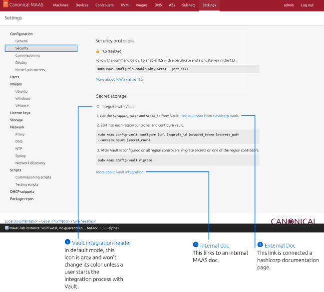

During migration, MAAS might be offline for a few seconds, but it will refresh quickly. After this command, MAAS will be fully integrated and functional with Vault. You can confirm success in the UI by checking Settings → Configuration → Security:
If you try to migrate secrets before all region controllers are configured with Vault, the migrate command will fail with an error message.
If you’ve configured all region controllers with Vault, but haven’t yet migrated the secrets, the integration process will simply remain incomplete. The UI will remind you:
