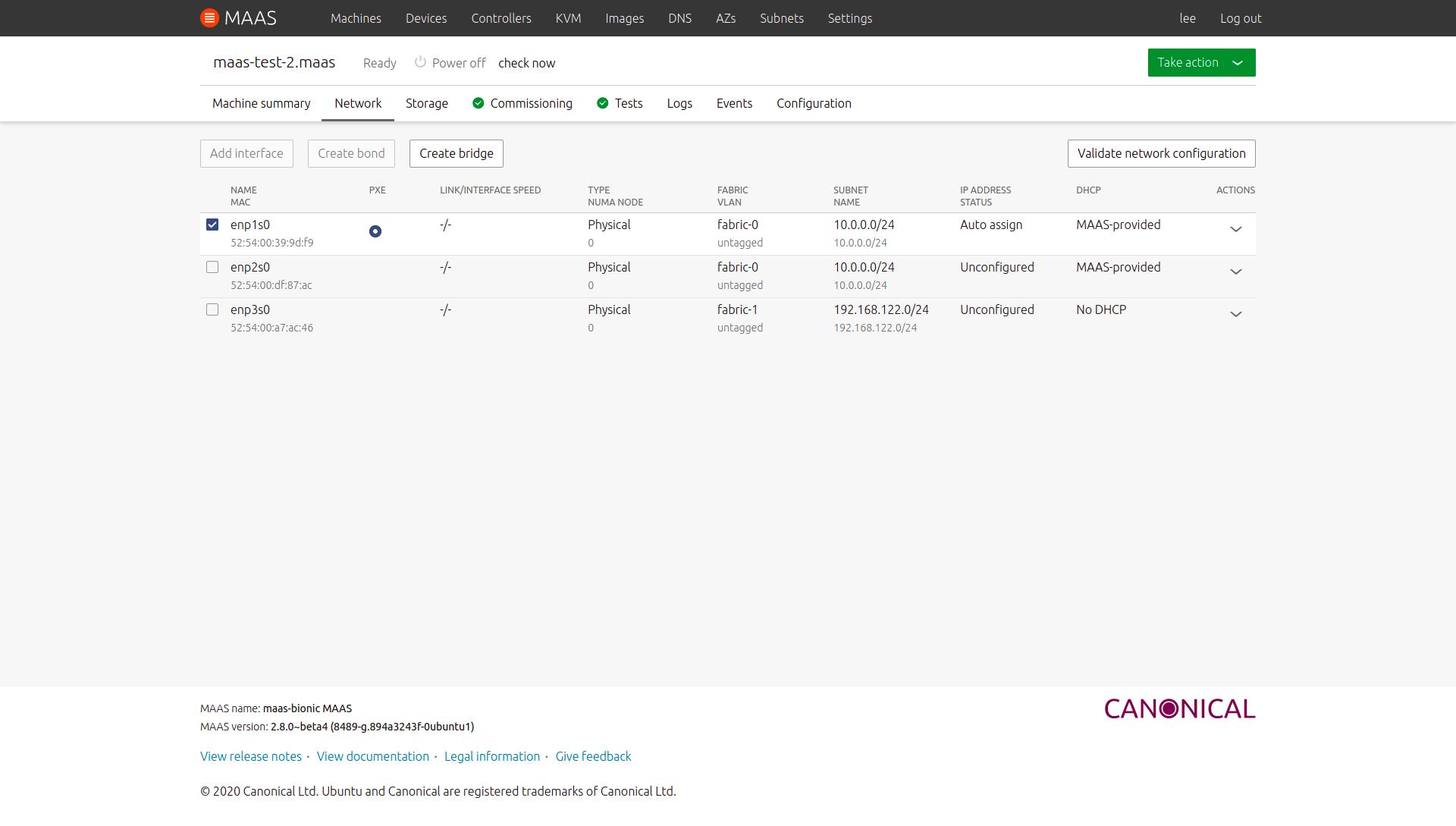

How to set up a VM host bridge with the web UI
You can use the MAAS UI to configure a bridge to connect a VM host to MAAS:
Select the machine you want to use as a VM host, switch to the “Network” tab. Select the network where you want to create the bridge and click “Create bridge:”
Configure the bridge on a subnet MAAS controls. You may use any IP mode for the bridge:
When you’re done, it should look something like this:
Then you can deploy Ubuntu.
