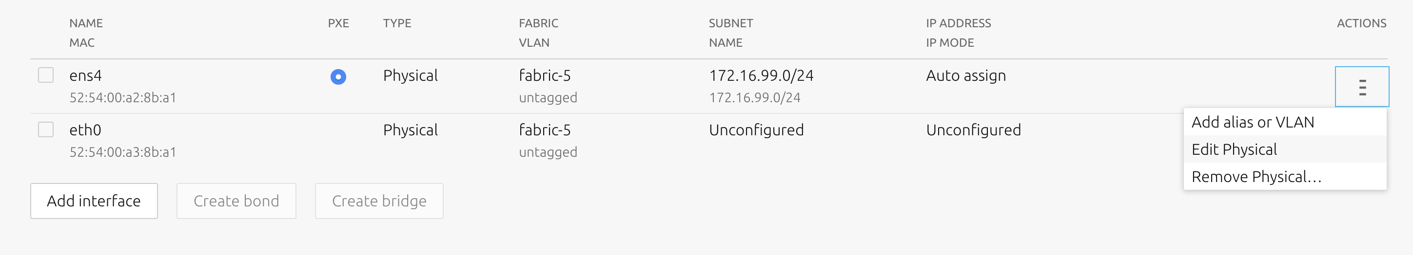

How to edit machines interfaces
From a machine’s “Interfaces” page, click the menu icon for the interface to be edited and select “Edit Physical” from the resulting menu:
The following window will appear:
Four modes determine how a subnet address is assigned when MAAS deploys the machine. You can select one of these modes by clicking on the “IP mode” drop-down menu.
  • Auto assign: MAAS will assign a random static address (iface eth0 inet static). The pool of available addresses depends on whether the subnet is managed or unmanaged (see Subnet management).
  • Static assign: The administrator will specify a static address using a secondary field.
  • DHCP: The machine leases a dynamic IP address, via either MAAS-managed DHCP or an external DHCP server.
  • Unconfigured: The interface is not configured.
Press the “Save” button to apply the changes.
