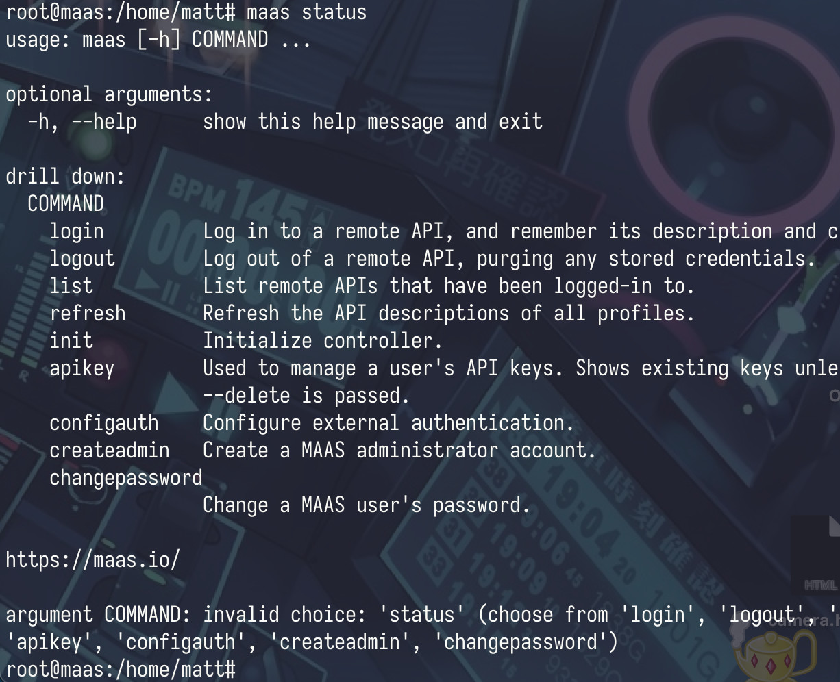

How to check the status of MAAS services
You can check the status of running services with:
sudo maas status
Typically, the output looks something like this:
bind9 RUNNING pid 7999, uptime 0:09:17
dhcpd STOPPED Not started
dhcpd6 STOPPED Not started
ntp RUNNING pid 8598, uptime 0:05:42
postgresql RUNNING pid 8001, uptime 0:09:17
proxy STOPPED Not started
rackd RUNNING pid 8000, uptime 0:09:17
regiond:regiond-0 RUNNING pid 8003, uptime 0:09:17
regiond:regiond-1 RUNNING pid 8008, uptime 0:09:17
regiond:regiond-2 RUNNING pid 8005, uptime 0:09:17
regiond:regiond-3 RUNNING pid 8015, uptime 0:09:17
tgt RUNNING pid 8040, uptime 0:09:15
