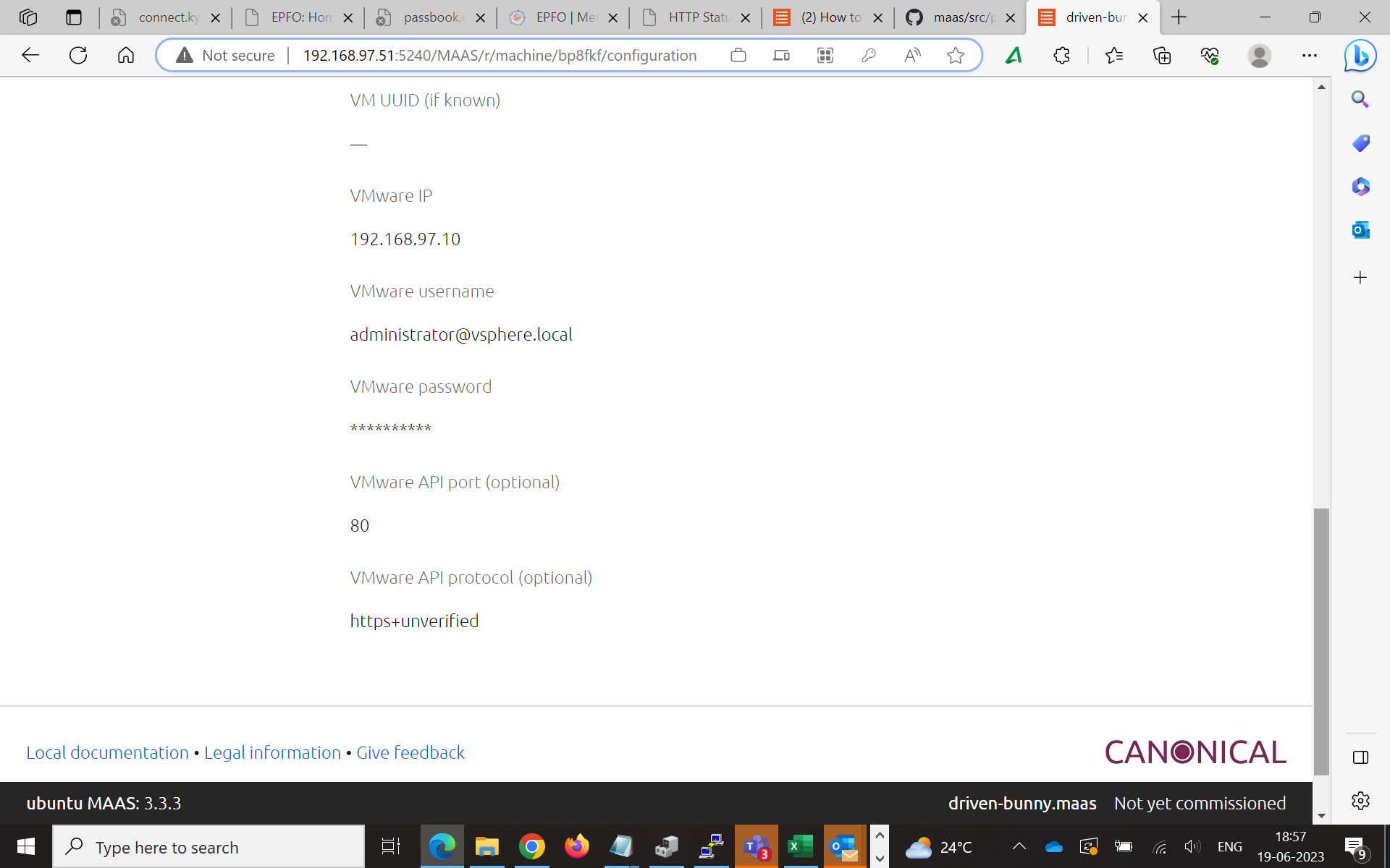

please find below parameters -
Did you have https+unverified before and that SSL issue happened with that option or you just added it and behaviour didn’t change?
Can you please attach full logs for the Rack controller?
Earlier I didn’t have this option, but even after adding https+unverified comminsioning is failing.
