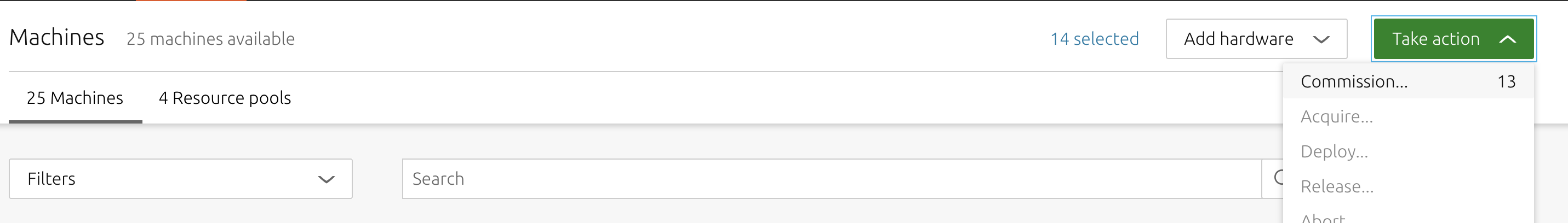

To commission a machine:
  1. Go to the “Machines” page.
  2. Select the machine(s) you want to commission.
  3. Choose “Commission” under the “Take action” drop-down menu:
You have the option of selecting some extra parameters (checkboxes) and performing hardware tests.
