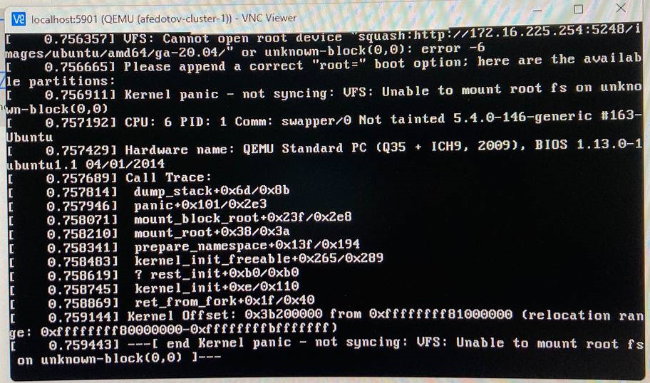

I still get some strange Marking node failed - Missing boot image custom/amd64/ga-20.04/rocky9 problem during deploy stage
This is how the problem looks like on machine which is being deployed; I wonder if ubuntu in URL is correct if I install rocky.
