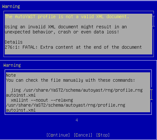

I am trying to build an openSUSE 15.6 image using packer-maas from GitHub. An earlier article from July 2023 mentioned that it should be possible to craft an openSUSE image using packer-maas, but it didn’t go into detail on the specific steps involved.
I encountered my first issue about missing python packages like pretty table, jinga2, etc. but managed to resolve it by commenting out certain packages that were not installed on my openSUSE 15.6 server. However, I’ve run into a second problem (attached as OpenSuse2), which suggests that my sles15.xml file might be incorrect. I have checked it against multiple XML validators, and I’m trying to validate it against the AutoYaST schema (profile.rng), but I can’t seem to find where that file has been moved to. I tried using:
wget https://github.com/openSUSE/yast-autoinstallation/blob/master/schema/profile.rng
Any assistance would be greatly appreciated. Thank you in advance!

Update:
I was able to to download the yast2-schema-default, convert it to .deb, install and find the elusive profile.rng file. I ran the command above and no issues found yet I still get that above error.
Steps taken:
OUTPUT:
server@PkgBldr:~$ sudo find / -name “profile.rng”
/usr/share/YaST2/schema/autoyast/rng/profile.rng
server@PkgBldr:~$ jing /usr/share/YaST2/schema/autoyast/rng/profile.rng /home/server/packer-maas/sles15/http/sles15.xml
server@PkgBldr:~$
server@PkgBldr:~$ xmllint --noout --relaxng /usr/share/YaST2/schema/autoyast/rng/profile.rng /home/server/packer-maas/sles15/http/sles15.xml
/home/server/packer-maas/sles15/http/sles15.xml validates
Hi Magicbuzz,
I don’t have a lot of experience with SUSE, but can you verify whether you executed the jing and yamllint commands in the help dialogue, and what the result of that was?
It looks like you may be using syntax unsupported in 15.6.
Without seeing your XML, it’s a little trickier to diagnose the issue. Could you open a bug report on packer MAAS, and include all the artefacts you’ve created to get an image?
Failing that, you should be able to skip the validation with the following boot parameter:
YAST_SKIP_XML_VALIDATION=1
but obviously it’d be preferable to fix rather than skip.
(https://www.suse.com/support/kb/doc/?id=000020329)
Hi Jack and thank you for responding - regarding the jing and yamllint commands - not sure I understand in the help dialogue? I did run them against my xml with no errors found but can run anything for you once I get clarity. Below are the hcl and xml files for review (sorry for the length) and steps performed.

            <uid>0</uid>
            <user_password>!</user_password>
            <username>root</username>
        </user>
    </users>
    <scripts>
        <chroot-scripts config:type="list">
            <script>
                    <!--  <filename>cloud-init.sh</filename>
                <interpreter>shell</interpreter>
                <chrooted config:type="boolean">true</chrooted>
                <source><![CDATA[
#!/bin/sh
systemctl enable cloud-init-local.service
systemctl enable cloud-init.service
systemctl enable cloud-config.service
systemctl enable cloud-final.service
                </source>
            </script>
        </chroot-scripts>
        <init-scripts config:type="list">
            <script>
                <filename>clean-persistent-net.sh</filename>
                <source><![CDATA[
#!/bin/sh
cat< /dev/null > /etc/udev/rules.d/70-persistent-net.rules
sed -i s/^root:[^:]*/root:*/ /etc/shadow
rm -rf /root/.ssh
rm -rf /root/.cache
rm -rf /etc/ssh/ssh_host_*
                </source>
            </script>
        </init-scripts>
    </scripts>
</profile>
STEPS
STEPS PERFORMED FOR INSTALL
1. sudo apt-get install qemu-kvm qemu-system-x86
2. wget https://download.opensuse.org/distribution/leap/15.6/iso/openSUSE-Leap-15.6-DVD-x86_64-Media.iso
3. vi .bashrc
	# Added
	export SLES15_ISO_PATH=/home/username/openSUSE-Leap-15.6-DVD-x86_64-Media.iso
4. git clone https://github.com/canonical/packer-maas.git
5. Made various edits to sles15.hcl among those enabling KVM, added iso cksum.
6. Got an error "Could not access KVM kernel module: Permission denied" fixed it with
	- sudo usermod -aG kvm <username>
7. Made various edits to have the image builder xml file to go online and pull down various python3 images and such, did not work.
   Create local/reachable repo server and posted the images there, confirmed access to those images to no avail. Below are the links
   to those packages should anyone want to try.
	- wget https://download.opensuse.org/repositories/devel:/languages:/python/openSUSE_Leap_15.6/x86_64/python3-distro-1.6.0-lp156.1.1.x86_64.rpm
	- wget https://download.opensuse.org/repositories/devel:/languages:/python/openSUSE_Leap_15.6/x86_64/python3-Jinja2-2.11.2-lp156.2.5.noarch.rpm
	- wget https://download.opensuse.org/repositories/devel:/languages:/python/openSUSE_Leap_15.6/x86_64/python3-jsonpatch-1.26-lp156.1.2.noarch.rpm
	- wget https://download.opensuse.org/repositories/devel:/languages:/python/openSUSE_Leap_15.6/x86_64/python3-PrettyTable-0.7.2-lp156.1.2.noarch.rpm
	- wget https://download.opensuse.org/repositories/devel:/languages:/python/openSUSE_Leap_15.6/x86_64/python3-PyYAML-5.3.1-lp156.2.2.x86_64.rpm
8. Commented out the following python packages in sles15.xml:
	<!-- <package>python3-dist</package> -->
        <!-- <package>python3-Jinja2</package> -->
        <!-- <package>python3-jsonpatch</package> -->
        <!-- <package>python3-jsonschema</package> -->
        <!-- <package>python3-oauthlib</package> -->
        <!-- <package>python3-PrettyTable</package> -->
        <!-- <package>python3-PyYAML</package> -->
        <!--<package>grub2-branding-SLE</package>--> <-- AI suggested commenting out this line
9. PACKER_LOG=1 packer build sles.pkr.hcl
10. I am now getting an error related to a misconfiguration in the xml file but have checked several ways.
