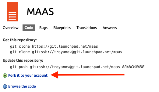

  1. Fork the repo
    Screenshot 2022-09-13 at 20.59.37
  2. Do the changes and push them to your forked repo
  3. Open your branch and make a merge proposal
    https://code.launchpad.net/~{username}/maas/+git/maas/+ref/{branch-name}
