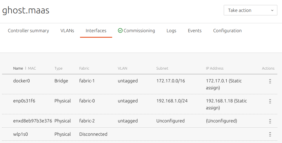

I tried to follow the directions here (MAAS | Fresh installation of MAAS, step 6) to setup DHCP. This instruction says to select the VLAN you want to enable DHCP for, select “take action,” and then “provide dhcp.” When I get to this step there is a dialog box titled “Default VLAN in fabric-2.” The first entry item is a dropdown menu saying “Rack controller.” However, there is nothing for me to select here (just an empty menu).
Here is a screenshot of my controller interfaces summary page, if it’s helpful:
When I go to the “Nodes” menu and then “controllers,” I see I have a region controller named “ghost.maas.” If I click on it and then go to the configuration edit page, I see an error message: “Editing is currently disabled because no rack controller is current connected to the region.” I’m not sure how to connect a rack controller to the region, and I’m also not sure how to configure my network setup and subnets.
