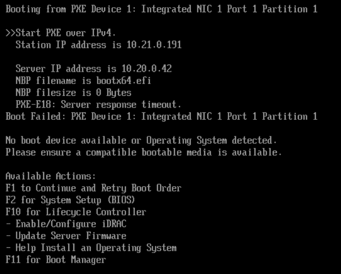

So now, how do I create a DHCP server in MAAS? I set one up on the same fabric (fabric-0) that the controller was using, and gave it 10.21.0.0/24, and PXE boot picked it up, gave it an IP (10.21.0.191) but then I got this:
If you keep 2 DHCP servers on the network this is not going to work. If you can’t get rid of your external DHCP server, I’d suggest you to configure it according to Having Trouble Deploying Maas Machine - #2 by r00ta and https://community.fortinet.com/t5/FortiGate/Technical-Tip-Configuring-FortiGate-for-PXE-Client-booting/ta-p/213404

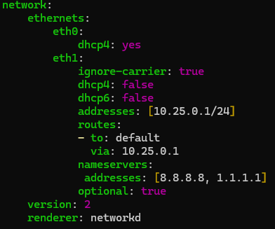

I set it up in Ubuntu netplan.

My netplan:

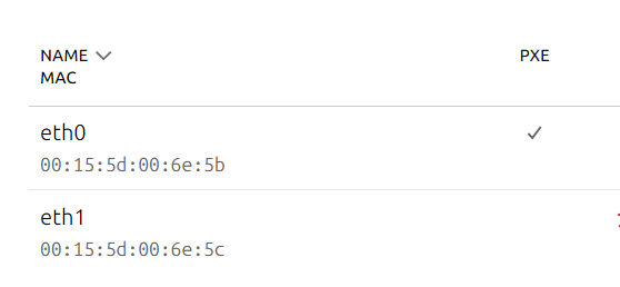

This is my controller network page, why is my eth1 not checked off for PXE?
The PXE info on the controller page is not relevant, you can ignore it. Now if your network is properly setup and the machines are configured to pxe boot in the subnets managed by MAAS DHCP it should work

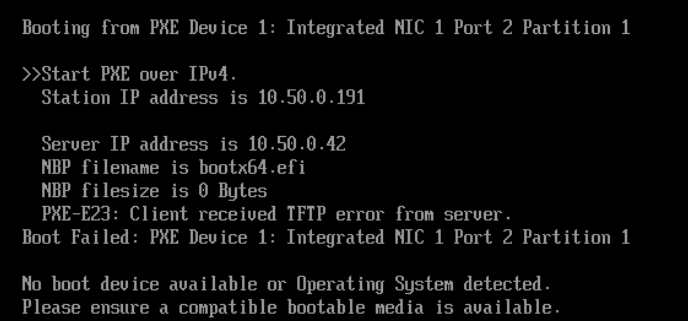

I switched my primary to a non-dhcp server, gave it a static IP and I can get PXE Booting recognized again but getting TFTP error from server
Why do you have 10.50.x now? In your MAAS only 10.20 and 10.25 are known subnets
