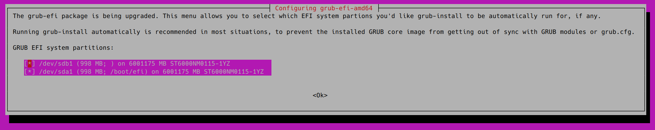

For now, I have prepared a workaround to be applied after deploying a server for some customers, with the help of gdisk/sgdisk to change the partition type properly to EF00, and by reconfiguring GRUB to enable multi(here the OS drives are sda and sdb) :
change the partition 1 of sda and sdb to EF00 instead of 8300
sudo sgdisk /dev/sda -t 1:EF00
sudo sgdisk /dev/sdb -t 1:EF00
(optional) if not done, format the secondary partition to vfat
sudo mkfs.vfat /dev/sdb1
(optional) mount the /boot/efi with “nofail” to not block the boot if the primary disk disappears (LP#2024869)
sudo sed -E ‘s/vfat(\s+)defaults/vfat\1defaults,nofail/’ -i ./fstab
reconfigure grub and enable multiple partition updates
sugo dpkg-reconfigure grub-efi-amd64
