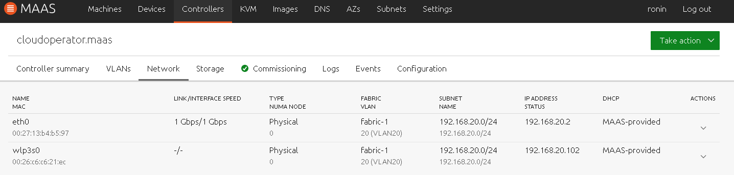

From my understanding the rack controller (Ubuntu18S3.maas) should be on VLAN5 as it has IP address of 192.168.5.2 but the MaaS UI is showing VLAN20. I think the HA-DHCP configuration must have messed it up but my assumption may be proven wrong here.
I have pasted the subnets and VLANS here as well:
Not sure why so many IPV6 subnets show up but I only marked the VLANS as tagged in order to ensure MAAS-provided DHCP would occur.
