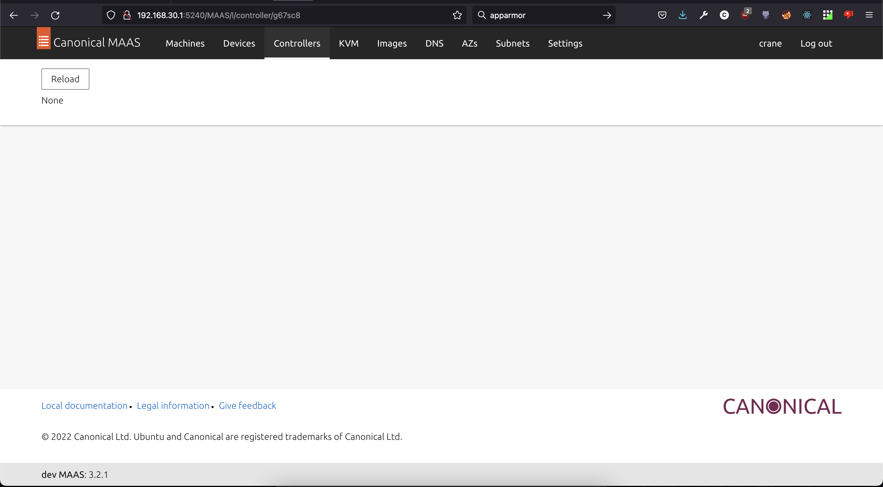

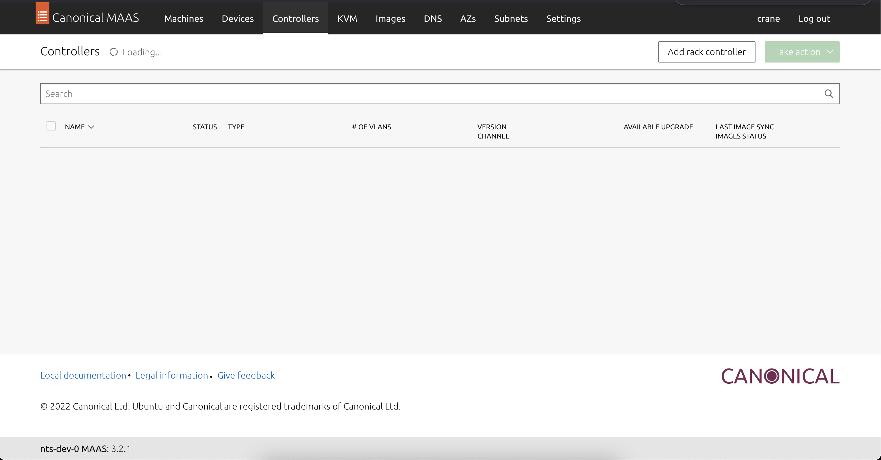

Yeah it is the same issue … The logs:
crane@nts-dev-0:~$ tail -f /var/snap/maas/common/log/regiond.log
File "/snap/maas/23093/lib/python3.8/site-packages/maasserver/websockets/base.py", line 553, in list
return [self.full_dehydrate(obj, for_list=True) for obj in objs]
File "/snap/maas/23093/lib/python3.8/site-packages/maasserver/websockets/base.py", line 553, in <listcomp>
File "/snap/maas/23093/lib/python3.8/site-packages/maasserver/websockets/base.py", line 233, in full_dehydrate
return self.dehydrate(obj, data, for_list=for_list)
File "/snap/maas/23093/lib/python3.8/site-packages/maasserver/websockets/handlers/controller.py", line 180, in dehydrate
vlan_counts[self._vlans_ha[vlan_id]] += 1
builtins.KeyError: None
2022-08-04 14:55:09 maasserver.websockets.protocol: [critical] Error on request (1) controller.list: None
File "/usr/lib/python3.8/threading.py", line 870, in run
self._target(*self._args, **self._kwargs)
File "/snap/maas/23093/lib/python3.8/site-packages/provisioningserver/utils/twisted.py", line 821, in worker
return target()
File "/snap/maas/23093/usr/lib/python3/dist-packages/twisted/_threads/_threadworker.py", line 46, in work
task()
File "/snap/maas/23093/usr/lib/python3/dist-packages/twisted/_threads/_team.py", line 190, in doWork
task()
--- <exception caught here> ---
File "/snap/maas/23093/usr/lib/python3/dist-packages/twisted/python/threadpool.py", line 250, in inContext
result = inContext.theWork()
File "/snap/maas/23093/usr/lib/python3/dist-packages/twisted/python/threadpool.py", line 266, in <lambda>
inContext.theWork = lambda: context.call(ctx, func, *args, **kw)
File "/snap/maas/23093/usr/lib/python3/dist-packages/twisted/python/context.py", line 122, in callWithContext
return self.currentContext().callWithContext(ctx, func, *args, **kw)
File "/snap/maas/23093/usr/lib/python3/dist-packages/twisted/python/context.py", line 85, in callWithContext
return func(*args,**kw)
File "/snap/maas/23093/lib/python3.8/site-packages/provisioningserver/utils/twisted.py", line 856, in callInContext
return func(*args, **kwargs)
File "/snap/maas/23093/lib/python3.8/site-packages/provisioningserver/utils/twisted.py", line 202, in wrapper
result = func(*args, **kwargs)
File "/snap/maas/23093/lib/python3.8/site-packages/maasserver/utils/orm.py", line 756, in call_within_transaction
return func_outside_txn(*args, **kwargs)
File "/snap/maas/23093/lib/python3.8/site-packages/maasserver/utils/orm.py", line 559, in retrier
File "/usr/lib/python3.8/contextlib.py", line 75, in inner
return func(*args, **kwds)
File "/snap/maas/23093/lib/python3.8/site-packages/maasserver/websockets/base.py", line 418, in prep_user_execute
return self._call_method_track_queries(
File "/snap/maas/23093/lib/python3.8/site-packages/maasserver/websockets/base.py", line 442, in _call_method_track_queries
result = method(params)
We should do a bug report on launchpad
