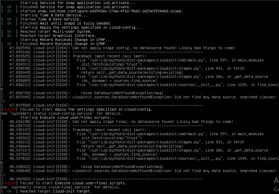

Failed to start execute cloud user final script while deploying rhel 9.4 converted image through canonical maas
Getting error while deploying RHEL 9.4 converted image through canonical-maas.
Error as follows,
“Failed to start execute cloud user final script”

Not by heart. That error usually is related to
  • multiple dhcp servers on the network
  • DNS issues
  • Other network issues
I’d suggest to double check these points and as last resort provide a full reproducer in a bug report

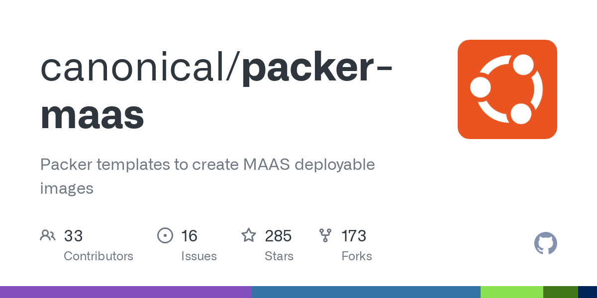

Can you share the script and files you used to build the custom image? Also, if you could upload it somewhere somebody might double check
I have used the package which is in git repository,
And also used rhel 9.4 iso downloaded from rhel website and same for OLE 8.9.

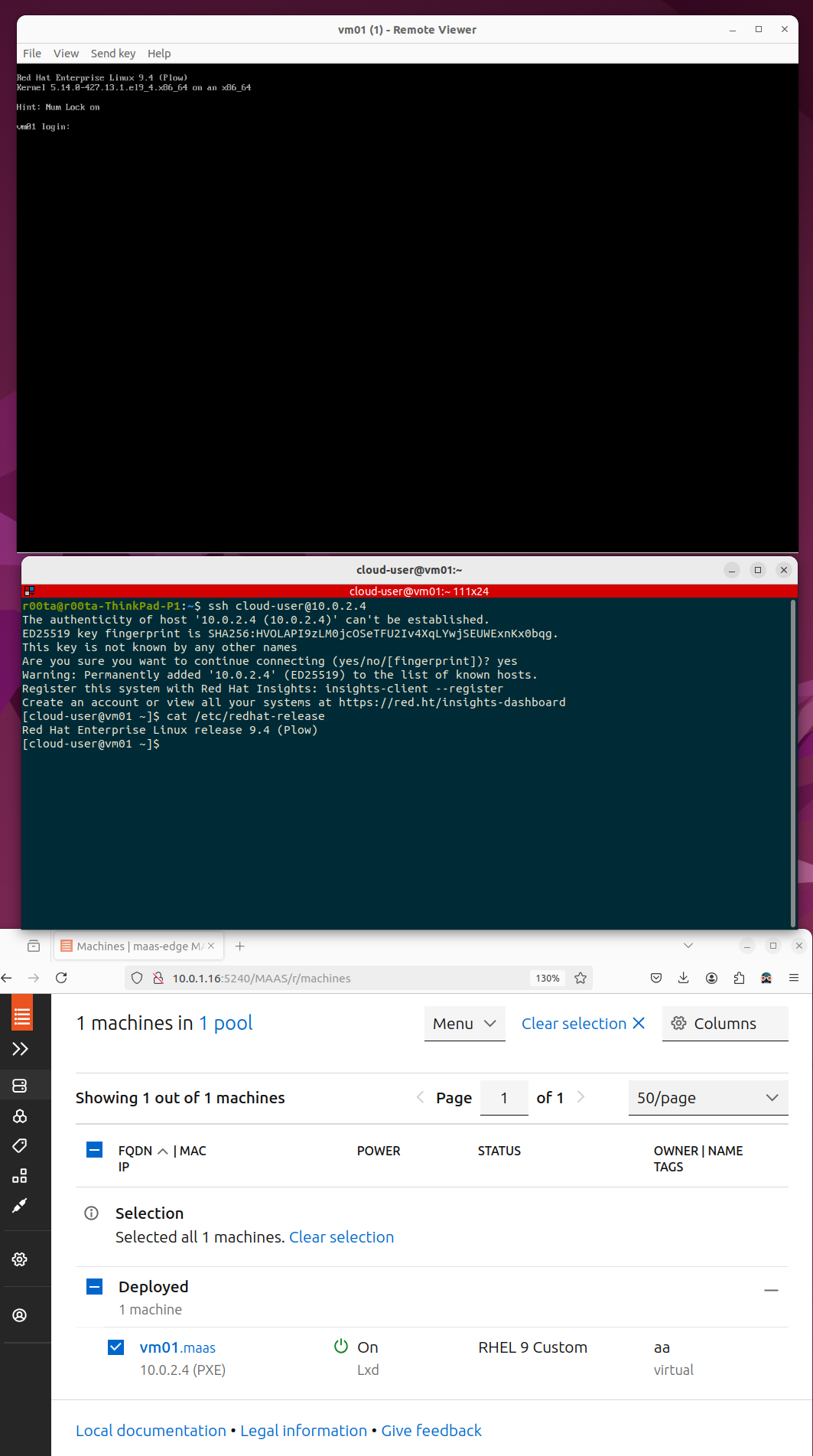

I just built a rhel 9.4 image and successfully deployed it in my test env. I’d suggest to double check once again your logs and ideally try in a simple test environment with some virtual machines
You have to download the official “offline install” rhel image https://access.redhat.com/downloads/content/rhel
Thanks for the update, can you please share what is the file extension of Rhel custom image after conversion?
Sure, It’s a .tar.gz
Thanks a lot, I am able to deploy rhel 9.4 custom image through canonical maas.
I have one query, after successful installation of rhel, what is the default credential for login ?
No password is automatically set. The ssh keys of the MAAS user that deployed the machine will be automatically added (I.e. just ssh cloud-user@ip -i private_key)
