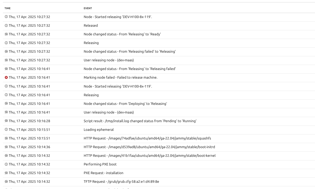

I’m currently running into an issue when deploying new machines. When they reach the stage of loading the custom image via HTTP requests, I try to release the machines instantly but it set the stage to failed to erase disk right away. I’m not sure MAAS support this or not, this only happen when I tried to release the machines when the custom image is loaded
I cannot find the exception log when MAAS set the state to "failed disk erasing " in the syslog
Screenshot 2025-04-10 at 17.01.47
Thanks in advance for all the help.

I was using the “Erase disks before releasing” option, and all of our machines are running RAID 1. When the machines are fully deployed, I can release them without any issues.
However, upon checking, I found that whenever I deploy a machine and release it, it fails as soon as it reaches the HTTP request for the custom image. The machine’s state is set to “Failed.”
I also tried aborting and releasing the machine without erasing the disks and MAAS set the state to “Deployment Failed” or “Failed to Release.”
Could it be that our custom image doesn’t meet the requirements or exceptions needed to allow releasing while the machine is still deploying?

All of our images are built using Packer, following the MAAS documentation. After several days of trying to figure out what cause the error, I discovered that even the default image provided by Ubuntu fails during the release or disk erasing stage when deploying the machine.

After reviewing the script results, this is the output I got. I didn’t notice any errors or issues.
This is easy to reproduce—just wait for the state to change from “Pending” to “Running”, and then perform an abort, release, or disk erase. This will cause the machine’s state to change to “Error”.
