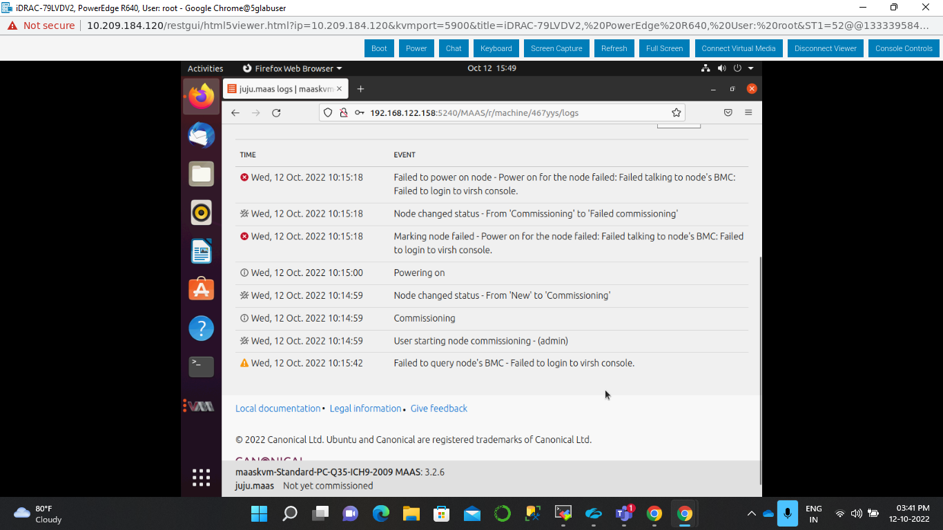

We are trying to install openstack charms, as a part of it we installed MAAS and attempted to create a MAAS cluster. We tried adding a Virtual Machine created on KVM to MAAS. But we faced an error, "Failed to power on node - Power on for the node failed: Failed talking to node's BMC: Failed to login to virsh console".
Systems used:
For MAAS → KVM Virtual Machine, Ubuntu 20.04, 8GB RAM, 50GB, 2 vcpus
For JUJU → KVM Virtual Machine, PXE boot, 4GB RAM, 50GB, 2vcpus
Steps followed:
Installed KVM on Ubuntu 20.04 server.
Created a VM for MAAS.
Installed MAAS. Followed https://docs.openstack.org/project-deploy-guide/charm-deployment-guide/yoga/install-maas.html .
Enabled DHCP for MAAS.
Created another VM for juju installation and set boot option to pxe boot.
Added the machine to MAAS using virsh power type. Followed https://ubuntu.com/blog/quick-add-kvms-for-maas this article.
When we try to commission the node, its failing and we are facing an error.
We are stuck here and would appreciate any help.

Hi @billwear , Thanks for responding. Below are the responses.
Output of snap list maas
Name Version Rev Tracking Publisher Notes
maas 3.2.6-12016-g.19812b4da 23947 3.2/stable canonical** -
Yes I am using UI

Hi @ben-ihelputech , Thanks for responding.
We are doing all this in one server only. I haven’t registered VM host in KVM section
. I directly tried adding VM to Machines
using virsh
. Will try registering the host first.
