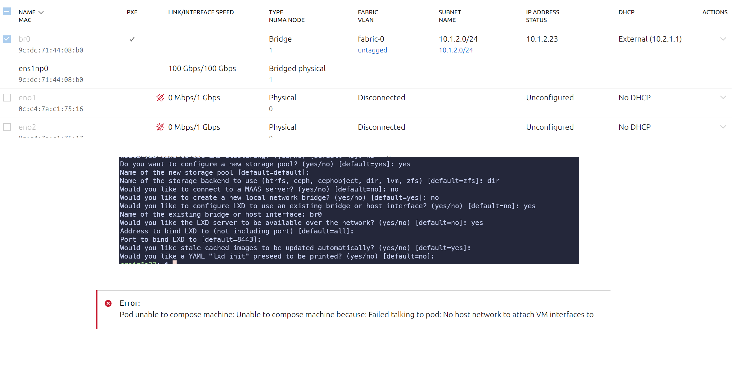

I am trying to get VM provisioning to work on a baremetal host but am running into the following error when trying to deploy VMs:
Pod unable to compose machine: Unable to compose machine because: Failed talking to pod: No host network to attach VM interfaces to
I couldn’t find any current documentation on how to setup the bridge network but this is what I have set up in the MAAS UI (first pic)
And my LXD setup (second pic)
Any tips here would be appreciated as I’ve been trying to get around this issue for weeks.
Resurrecting the dead here, but I’ve got the same issue. Simply deployed a machine with the KVM option. Afterwards, trying to create a VM with default settings results in the above mentioned error.
In my case it was picky about the DHCP server. I was using my own. Once I enabled MaaS’ DHCP server in the vlan, it started working.

I think MAAS could benefit from another setting in a VLAN’s DHCP config, namely, explicitly setting an option signalling that there is an external DHCP server which is compatible with MAAS. In that case the logic in the code would run as normal without the error the topic-starter and I saw.
You should disable the LXD DHCP in the subnets that you use to PXE the VMs
Those LXD DHCP are not the problem, they are off already.
In my case I had to enable the MAAS dhcp before things started working. I never had a MAAS DHCP because in my case my lab router provides that already and normal bare metal machines provisioned fine with MAAS plus that existing non-MAAS dhcp server.
I’m hoping that MAAS can be more open to using an existing DHCP server in the case of LXD functionality.

There is some logic in MAAS that is matching subnets where you have DHCP enabled. This is because MAAS does not know if the external DHCP server is actually pointing to MAAS, so this needs some thinking as we might need the user’s input.
