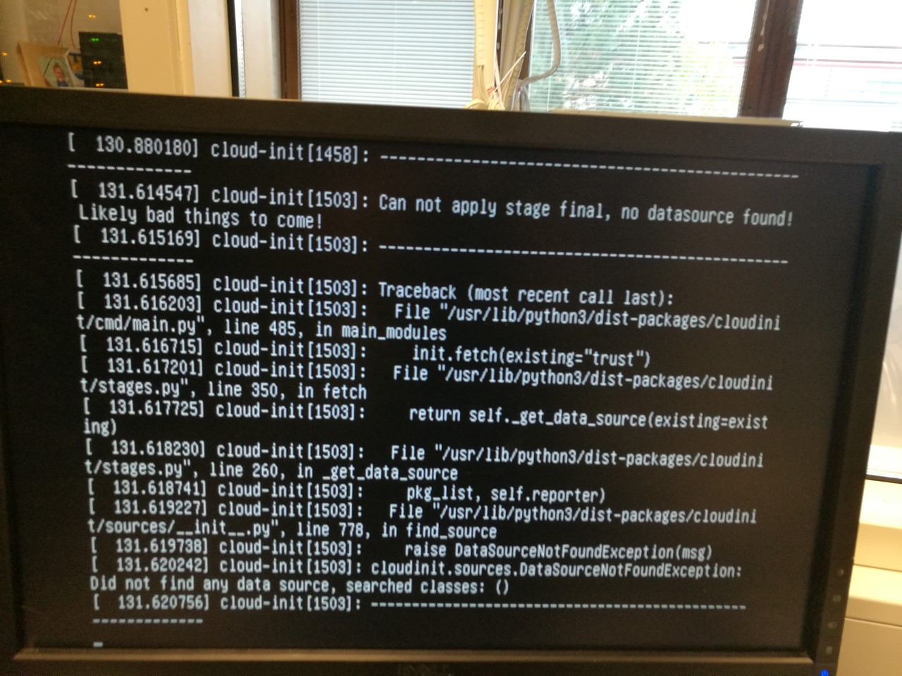

A strange error message appeared while I was attempting to add a new machine to MAAS. The PXE boot starts normally and it does seemingly boot in the correct network. However, the machine doesn’t get added and an error message like this appears on the machine I’m trying to add:
While searching around, I found out that this used to be a problem with older versions of MAAS, where the machine being added didn’t have a connection with both the rack and the controller. Could this be caused by something similar?
(Bug #1779970 “Cannot find cloud-init datasource error when addin...” : Bugs : MAAS) A link to an older conversation about the error, from a user running the 2.3 version of MAAS. I should note that unlike the original poster here, I haven’t added any rack controllers in different networks or anything similar.
For the record, my server is running the 2.7 version of MAAS. I was planning to upgrade to 2.8 after figuring out this error, but of course I don’t mind upgrading sooner if that might help in solving the problem.

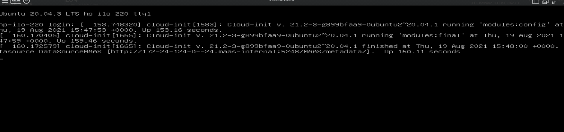

In the case of 3.0, I was commissioning 7 roughly identical machines. They were all the same make, same BIOS, but some had more disk than others and some had better CPUs and more memory. But no system was unique. One of the 7 machines consistently refused to commission. It either hung up trying to boot initrd or it would fail with the infamous “no datasource” error. The one that failed was one of 4 identical machines.
I switched to using 18.04 for commissioning and it passed first try.
So again, just to be clear. I am asking for help diagnosing the issue. Are there logs I can/should look at or do I need to use tcpdump?
Is there anything that I should look at on this particular host (now that UB20.04 is deployed on it).
