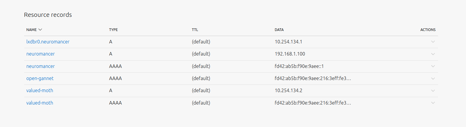

can you show me a screenshot of the DNS record that disappears?
This is the first deployed vm from lxd vmhost
Which was given the hostname as DNS from MAAS
After create a new vm, the dns record was removed from MAAS
And only the new vm get to be assigned with the DNS record
I think the pattern I observe is that only the last vm created get attributed a DNS record, hope this helps.
so you are looking at this list?
maybe you could show me the whole list? does the machine that “loses” a DNS record switch from “A” to “AAAA” ? and can you tell me what problem this is causing? is something failing to function because of this behavior?
It just disappears so it’s not on the list.
I was installing some workload on the vms, and would like to use the dns name to point to other services.
okay, that sounds like a bug. please file a bug report and make sure to get screenshots of the list with the other VMs missing. thanks.
