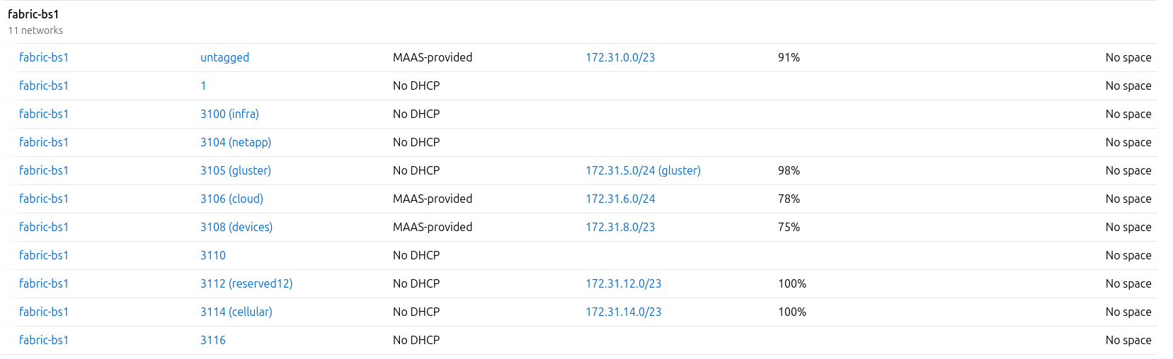

I’ve recently had to update Ubuntu from 22.04 LTS to 24.04 LTS. After the update I also went ahead and updated MAAS from v3.3 to v3.7 (Debian packages). However, since then I have problems with the DHCP configuration.
So far, I’ve figured out, that /var/lib/maas/dhcpd-interfaces and the respective dhcpd_.conf are all empty. On each restart, the maas-dhcpd_.service fails, because the dhcpd_.conf files are initially missing.
On the Web UI, everything looks good. I have a fabric with VLANs and subnets defined. For some MAAS manages DHCP.
I can’t find a reason, why MAAS doesn’t pick up the DHCP configuration. Any help in troubleshooting this problem is highly appreciated. :pleading_face:
