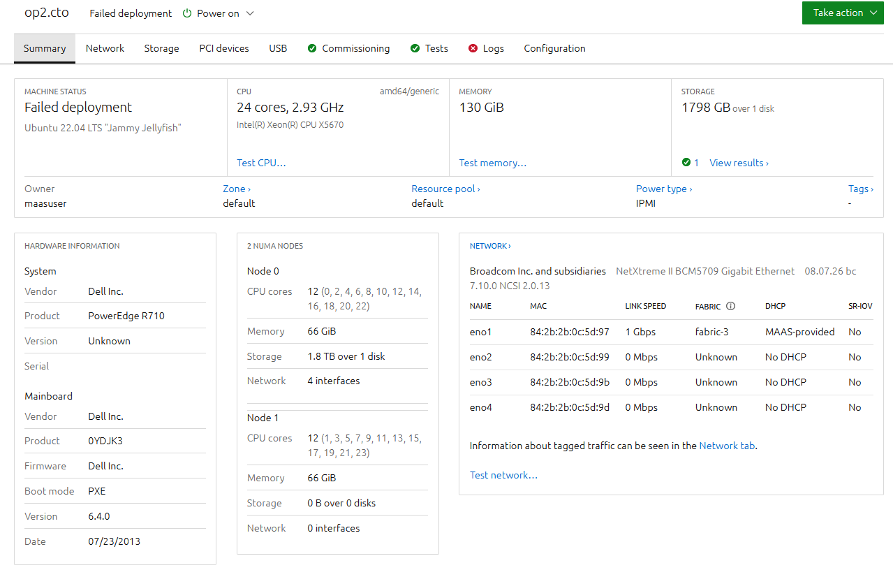

Continuing with my previous post about MAAS and installing in poweredge r710 with idrac6.
Installing Ubuntu over Dell poweredge R710 machine with iDRAC6)
After the post under BMC I did enable IPMI over LAN option, DHCP for ethernet port. Once I reboot the server with PXE boot option, MAAS is able to detect and start the server with ephemeral image successfully setting ipaddress to first inband ethernet port.
I tried commissioning the server and it is successful.
Now when I am trying to deploy it fails and ends up shutting down the server. Logs shown in MAAS are not useful and need your help in troubleshooting the same .

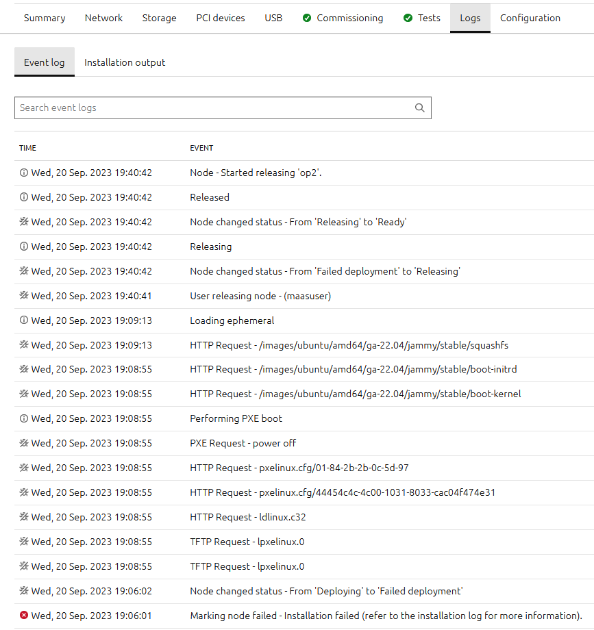

Under logs tab in GUI, I dont see any failure logs of why deployment failed.
Can you send a screenshot of the Logs page anyways just to double check?

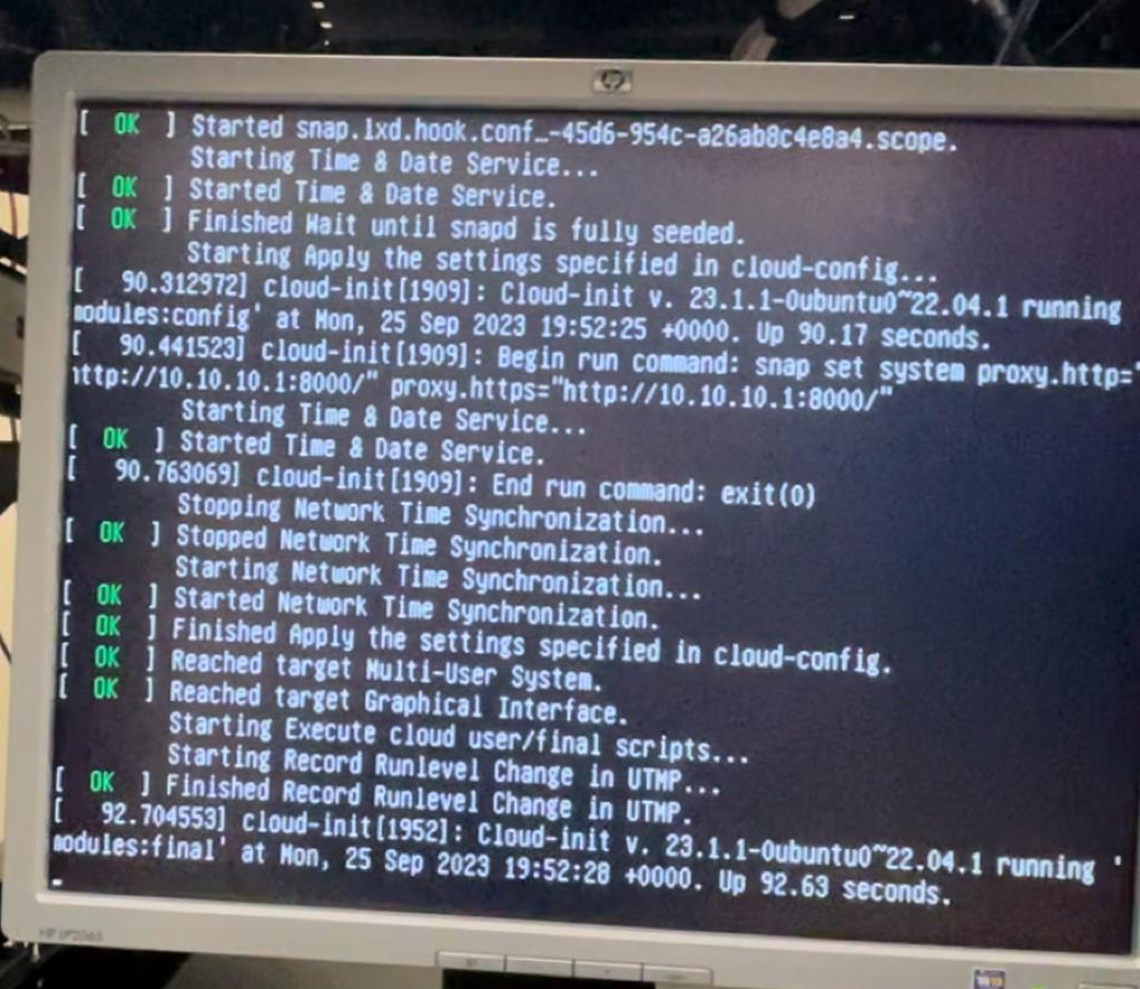

I got a chance to try the same. From my MAAS UI once the machine is in Ready State, I have selected Deploy option picking Ubuntu 22.04 as the OS image.
Server ended up getting rebooted in ephemeral image and I can see the login prompt. Now I started to see below time sync errors
After that server ended up rebooting again. On successfully rebooting to login prompt it just powered off.

Only when the cloudinit script is executed it points to time as 02:51:42 instead of 07:52

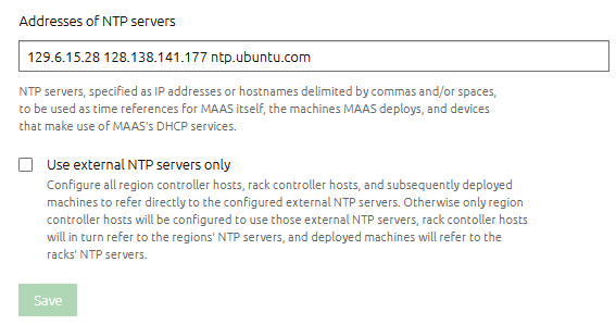

Meanwhile I tried changing NTP settings in MAAS as shown below and the deployment of the OS worked successfully with the Ubuntu server 22.04
I think it is a DNS issue but not clock issue.
NOTE: I only have one VM in which MAAS is installed which is acting as both regiond and rackd instead of 2 seperate instances.
