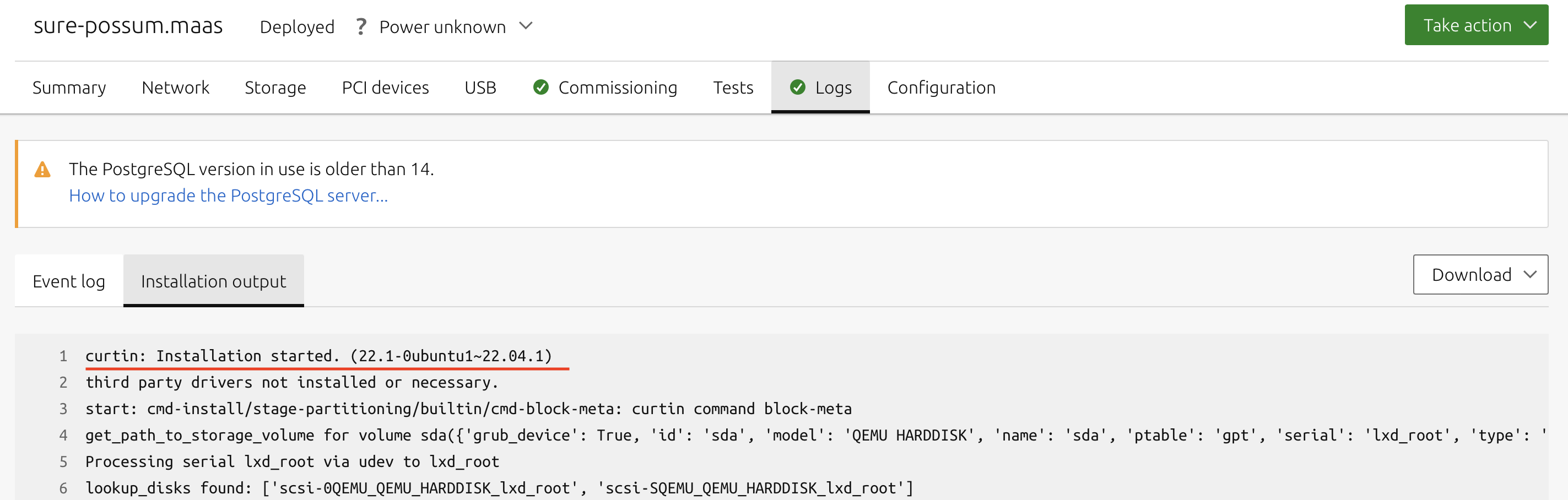

Is there a way to check for curtin version in MAAS? Either by CLI or through UI?
Hi @shibayanc
You can check the version of curtin
used for deployment from the Installation output
tab inside Logs
via MAAS UI.
In general MAAS will use version of curtin
from MAAS PPA, but in case of a deb
installation, it can be forced to use a different version installed on the system.
