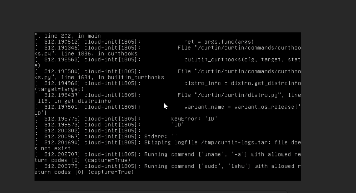

Hi I am facing the same issue but trying to build a custom image for microOS from leap - SUSE.
Does anyone know how to fix it?

  3. Facing the exact same error as the original POST.

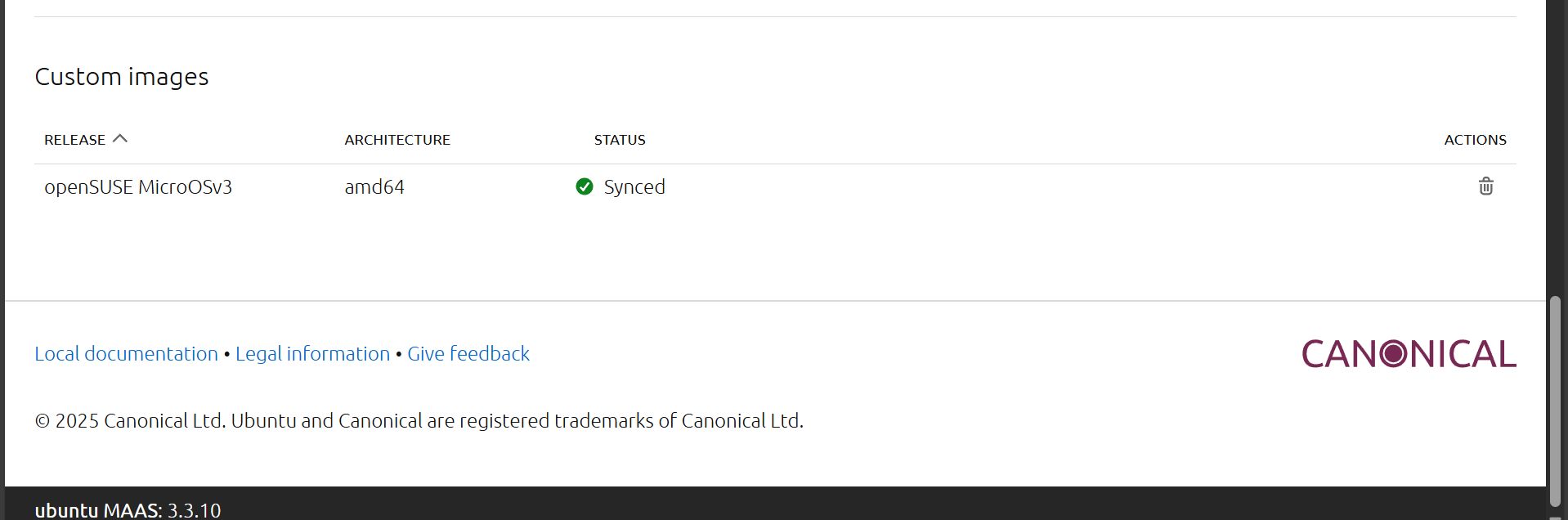

    The command I used to upload the image is:
maas admin boot-resources create name=‘custom/microos’ title=‘openSUSE MicroOSv2’ architecture=‘amd64/generic’ filetype=‘tgz’ content@=micros.tar.gz

I made sure the os-release is there in the /etc/
Please retry uploading the image with a name that starts with suse/.
I did, but the issue persists :frowning: should I try ubuntu/microOS ?
what MAAS version are you using ?
I am using MaaS 3.3.10
please try with a more recent version of MAAS, 3.3 is pretty outdated
Same result :frowning: And I needed to remove all the configuration of the old db. Cause it was conflicting with the upgrade.
