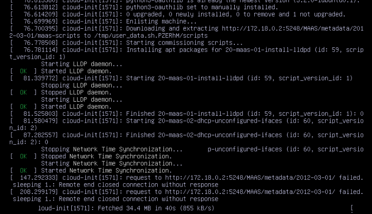

I have been wrestling with this problem and am struggling.
I have a machine (Minisforum MS-01) is able to be discovered but fails to commission. The failure is odd. I have attached a screenshot from the remote KVM but it seems to download the scripts just fine but appears to timeout during the 20-maas-02-dhcp-unconfigured-ifaces script. I have tried many network combinations to see if it is a certain config that is causing problems. When I browse to that URL I am able to get the response back no problem.
To be honest I am not sure where to start with troubleshooting this as I am not sure I am able to log into the machine via the console during that process to view the network stack.
Any advice is appreciated!

Interestingly enough. When I look at the ports during discovery and commissioning it appears that the non PXE nic never comes up all the way. It stays in a FastEthernet state (I believe that means 100M) while the other one registers as a full 2.5G
Screenshot 2024-12-07 085247
More color around these ports. They are vPro (AMT) capable ports. So while the machine is “off” these ports remain on in a low power state to allow for AMT remote access. It feels to me that the second port is not fully coming “UP” during the pxe process.
Well, I am seeing the same behavior with an old beelink mini pc I have laying around. When I provision to LXD, running on the maas server I do not see this.
Welp, jumbo frames appear to be the cause of all of these problems. A little packet snooping showed a lot of re-transmits and malformed packets. While I would like this to be set, that is a problem for another day.
