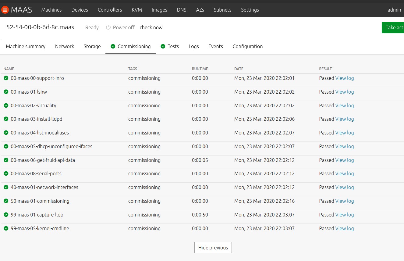

Commissioning logs, which are presented on the “Commissioning” tab for any machine in the “Ready” state, contain a list of commissioning scripts with a timestamp and result. You can view the detailed logs for each of these scripts from this tab.
When you click on the “Commissioning” tab under a given machine, you will see a screen similar to this one:
Each of the items in the “NAME” column is the name of a commissioning script. Each entry gives a timestamp and a result (e.g. passed, failed, …). At the end of each line is a link to view the log. It’s worth taking a look at each of the script logs and their typical output.

Here’s a quick breakdown of what you see in the script output:
KERNEL INFO: this is the output of uname -a– the MAC address is the machine name in this case.
KERNEL COMMAND LINE: these are the kernel command line parameters, directed at various modules built into the kernel. The function modprobeparses this kernel command line and collects the relevant module parameters when it loads a module. Note that this command line could also be used to pull in loadable modules.
CLOUD CONFIG QUERY: a cloud-init query is used to retrieve cloud instance metadata used by cloud-init when booting an instance. This section shows the specific metadata retrieved during cloud-init query for this machine.
CPU CORE COUNT AND MODEL: the data produced here is similar to the output you could retrieve by running nprocand then attempting acat /sys/devices/cpu/caps/pmu_name– and so on. There several ways to retrieve this info, but all can produce the number and type of CPU(s) available.
PCI INFO: the devices, real or virtual, that are connected to the machine via PCI (Peripheral Component Interconnect) bus.
USB INFO: the devices, real or virtual, that are connected to the machine via USB bus.
MODALIASES: a modalias is a sysfs technique to capture the information that a hardware item exposes to the kernel, with the file basically providing a template or structure for this information. Each of the entries in this list describe one particular part of the machine’s (real or virtual) hardware, down to the level of alarm timers, framebuffers, and even speakers. In the event of a bug, this information can help your support engineer (or yourself) understand exactly what hardware is configured for this machine.
SERIAL PORTS: this section just lists the serial devices made available on this machine.
NETWORK INTERFACES: summarises the network interfaces available on this machine – essentially an abbreviated version of the output from some form of an ipcommand.
BLOCK DEVICE SUMMARY: a thumbnail sketch of the block devices (usually storage) available on this machine.
#dmidecode…: this section presents the basic DMI data, including the BIOS type, extent, size, and table location.
DMI DATA: the raw (undecoded) DMI table for this machine, presented for verification of the following DMI data sections, if desired.
DMI KEYPAIRS: the individual machine specifications, as decoded from the DMI table. The manpage dmidecode (8) gives more details on each of these keypairs.
maas-lshw
This script pulls system BIOS and vendor info, and generates user-defined tags for later use.  maas-lshw runs in parallel with other scripts to speed up the commissioning process. Typical script output from a successful run looks something like the foldout below.

20-maas-01-install-lldpd
This script installs the link layer discovery protocol (LLDP) daemon, which will later capture networking information about the machine. This logs the basic install process to the commissioning logs in real time.
maas-list-modaliases
This script figures out what hardware modules are loaded, providing a way to autorun certain scripts based on which modules are loaded.  maas-list-modaliases runs in parallel with other scripts to speed up the commissioning process.  Successful log output looks something like the foldout below.

20-maas-02-dhcp-unconfigured-ifaces
MAAS will want to know all the ways the machine is connected to the network. Only PXE comes online during boot; this script brings all the other networks online so they can be recognised. This script logs the discovery of these networks to the commissioning logs.
maas-get-fruid-api-data
This script gathers information for the Facebook wedge power type, and it runs in parallel with other scripts to improve commissioning speed. Typical output from a successful run looks something like the foldout below.

maas-serial-ports
This script lists what serial ports are available on the machine; it runs in parallel to speed up commissioning. Log output from a normal, successful run is simply a list of serial ports, something like the foldout below.

40-maas-01-network-interfaces
This script is just used to get the IP address, which can then be associated with a VLAN/subnet.  As you can see from the sample (successful) output below, the results are simply the output of a command similar to ip a.

The commissioning script 40-maas-01-network-interfaces is no longer used in MAAS versions 3.0 and higher.
50-maas-01-commissioning
This script is the main MAAS tool, gathering information on machine resources, such as storage, network devices, CPU, RAM, etc. We currently pull this data using lxd: We use a Go binary built from lxd source that just contains the minimum source to gather the resource information we need.

2020-03-23 22:02:16 (17.3 MB/s) - ‘/tmp/user_data.sh.EK9wIv/scripts/downloads/50-maas-01-commissioning/amd64’ saved [4373408/4373408]
    "cpu": {
        "architecture": "x86_64",
        "sockets": [
                "name": "Intel Core Processor (Skylake, IBRS)",
                "vendor": "GenuineIntel",
                "socket": 0,
                "cache": [
                        "level": 1,
                        "type": "Data",
                        "size": 32768
                        "level": 1,
                        "type": "Instruction",
                        "size": 32768
                        "level": 2,
                        "type": "Unified",
                        "size": 4194304
                        "level": 3,
                        "type": "Unified",
                        "size": 16777216
                "cores": [
                        "core": 0,
                        "numa_node": 0,
                        "threads": [
                                "id": 0,
                                "thread": 0,
                                "online": true
        "total": 1
    "memory": {
        "nodes": [
                "numa_node": 0,
                "hugepages_used": 0,
                "hugepages_total": 0,
                "used": 876933120,
                "total": 1032945664
        "hugepages_size": 2097152,
        "used": 164585472,
        "total": 1032945664
    "gpu": {
        "cards": [
                "numa_node": 0,
                "pci_address": "0000:00:02.0",
                "vendor": "Red Hat, Inc.",
                "vendor_id": "1b36",
                "product": "QXL paravirtual graphic card",
                "product_id": "0100"
        "total": 1
    "network": {
        "cards": [
                "driver": "virtio_net",
                "driver_version": "4.15.0-91-generic",
                "ports": [
                        "id": "ens3",
                        "address": "52:54:00:0b:6d:8c",
                        "port": 0,
                        "protocol": "ethernet",
                        "port_type": "other",
                        "transceiver_type": "internal",
                        "auto_negotiation": false,
                        "link_detected": true
                "numa_node": 0,
                "pci_address": "0000:00:03.0",
                "vendor_id": "1af4",
                "product_id": "0001"
        "total": 1
    "storage": {
        "disks": [
                "id": "sda",
                "device": "8:0",
                "model": "QEMU HARDDISK",
                "type": "scsi",
                "read_only": false,
                "size": 5368709120,
                "removable": false,
                "numa_node": 0,
n                "device_path": "pci-0000:00:01.1-ata-1",
                "block_size": 512,
                "firmware_version": "2.5+",
                "rpm": 0,
                "serial": "QM00001",
                "device_id": "ata-QEMU_HARDDISK_QM00001",
                "partitions": [
                        "id": "sda1",
                        "device": "8:1",
                        "read_only": false,
                        "size": 5367643648,
                        "partition": 1
        "total": 2
This output represents a catalogue of the resources available on this machine, in a format readable by both humans and machines. You can use this to verify that your configuration is what you expected.
maas-capture-lldp
This script gathers LLDP network information to be presented on the logs page; this data is not used by MAAS at all. The script runs in parallel with other scripts for speed. Note that the log output from a successful run is uninteresting.
maas-kernel-cmdline
This script is used to update the boot devices; it double-checks that the right boot interface is selected. Successful output is the specific command that boots the machine kernel, something like this:
nomodeset ro root=squash:http://192.168.122.2:5248/images/ubuntu/amd64/generic/bionic/daily/squashfs ip=::::52-54-00-0b-6d-8c:BOOTIF ip6=off overlayroot=tmpfs overlayroot_cfgdisk=disabled cc:{'datasource_list': ['MAAS']}end_cc cloud-config-url=http://192-168-122-0--24.maas-internal:5248/MAAS/metadata/latest/by-id/pb6833/?op=get_preseed apparmor=0 log_host=192.168.122.2 log_port=5247 BOOTIF=01-52:54:00:0b:6d:8c
These are the kernel command line parameters, which control the invocation of various modules built into the kernel.  The function modprobe parses this kernel command line and collects the relevant module parameters when it loads a module.  Note that this command line could also be used to pull in loadable modules.
