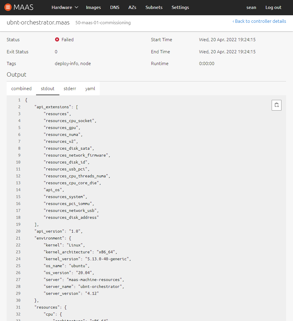

It appears to be failing on the 50-maas-01-commissioning script. The STDOUT of the script looks right. But I get an error about a string literal with NUL (0x00) characters in the regiond.log
Here’s the end of the error:
File "/snap/maas/19835/usr/lib/python3/dist-packages/django/db/backends/utils.py", line 84, in _execute return self.cursor.execute(sql, params) builtins.ValueError: A string literal cannot contain NUL (0x00) characters.

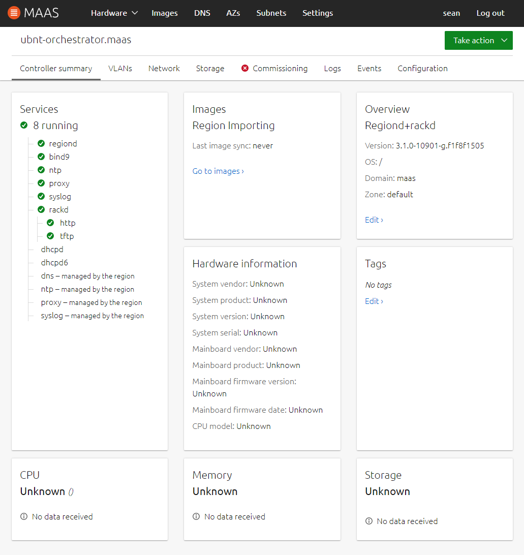

The Controllers tab shows a green check like everything is good,
…but under the Commissioning tab, it shows a Failed:
STDOUT has the output of the script, but STDERR just says Empty file.
