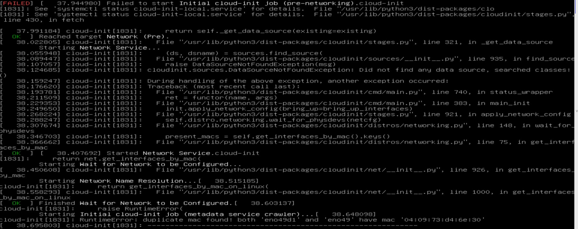

I recently had to delete and recommission two servers and now both servers are failing to enlist.
The servers were configured with two bonded interfaces before and somehow that seems to be persisted somewhere.
I think that leads to the error I captured from the initial pxe boot. He tries to start the interfaces with the initial config, but fail due to the duplicate mac. I have no idea where to fix this. The servers where deleted through the webinterface.

I enabled the local login in the image and the pxe image boots with the duplicate mac address. I have no idea where that configuration comes from. I tried to change the mac address of the second interface to its default one but it does not survive the next boot.
I do not know if the wrong configuration gets pulled from maas or is persisted at some other point.

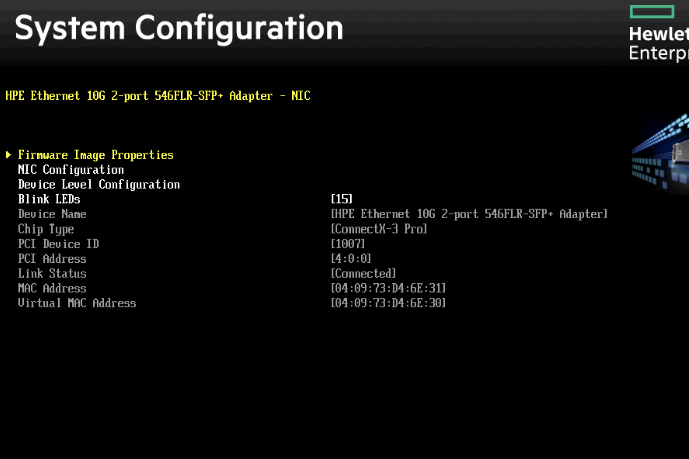

I got a little further. I updated the driver of the network card and now it show a virtual mac in the bios. I have no idea how to delete this and how maas did set it.
@benvandamme0, did you get anywhere with this? it looks like the BIOS is “echoing” the MAC address, which may be confusing MAAS. can you give me an update?
