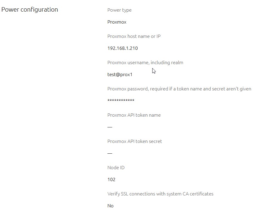

So been slowly working on this in my spare time, got a test setup working now, one issue I am having is how do you setup the proxmox power control?
I have tried every version of the syntax I can figure out but it never seems to work? I also can not find any details online of how the syntax works.

  1. Can you please check rackd.log for any errors? More about MAAS logs here
  2. Can you please provide your power config and describe the issue you observe?

Near as I can make out this should be the correct syntax:
But the only error I can find is : Failed to query node’s BMC - Request failed with response status code: 401.
