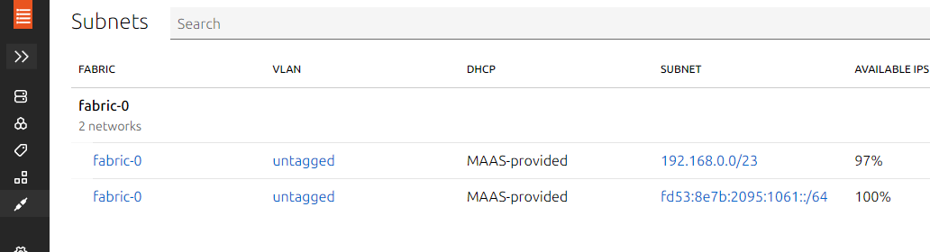

But when MAAS assigns ip addresses it is assigning them on the home network 192.168.1.xxx.
I think the problem is my subnet settings.

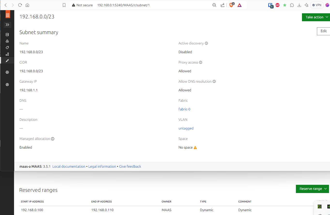

In my subnet I pointed to the Asus router (which is on 192.168.1.1 the home network) as the gateway and that gave me a subnet cidr of
192.168.0.0/23 which is
192.168.0.0 - 192.168.1.255
If I try to make my subnet 192.168.0.0/24 to be just the .0 addresses then it complains because my gateway is not in the subnet.
Should I have my gateway not point to the Asus?
and
My goal was to have MAAS assign in the range of 192.168.0.100 to 0.110
You can create a dynamic range from 192.168.0.100 to 192.168.0.110 and a reserved range from 192.168.1.1 to 192.168.1.255
Thank you. I will do that now. Then I will recreate my Juju install and see how it works.
That worked but it makes me wonder if I am mistaken on the dynamic range setting. I thought that was going to be where IP addresses are assigned from. I will google that more. Thanks.
The dynamic range is the one used to boot ephemerally a machine (for example when you commission on) or when you assign an interface to the type DHCP.
The reserved range is used to tell MAAS not to use any IP address there.
Every other IP address not in the dynamic range nor the reserved range can be used by MAAS when you an interface of type “AUTO-IP”
