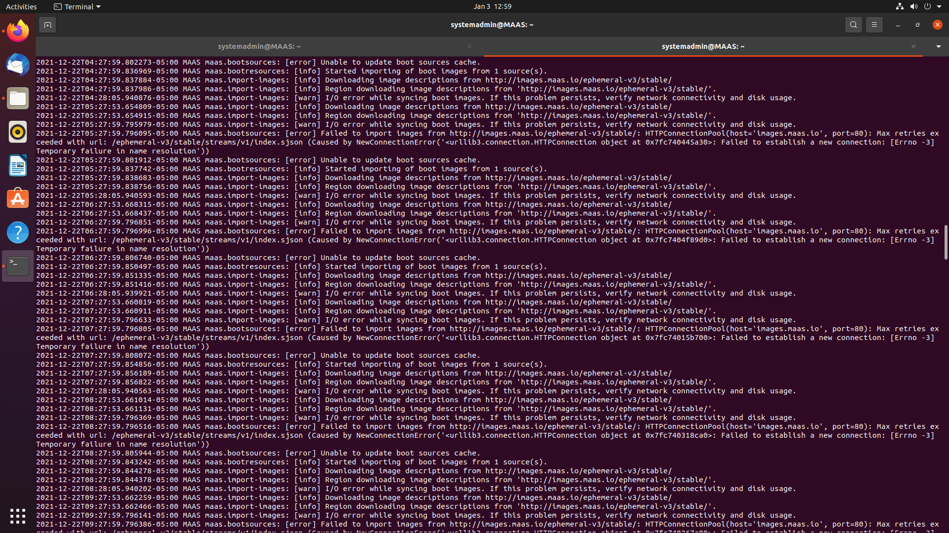

Please see logs
sudo tail /var/snap/maas/common/log/maas.log

Yea I have all sorts of problems now, and quickly scrolling through I’m not sure if it has anything to do with the Mellanox related stuff.
In the new year now. I’m having issues with the Mass Controller not fully operational. One of the errors popping up in the controller dashboard is… Mount the root ‘/’ filesystem to be able to deploy this node.
I have Maas in an ubuntu focal fossa VM in Hyper-v, on one of my DL380Ps, with a 40GB virtual disk for the controller VM.
