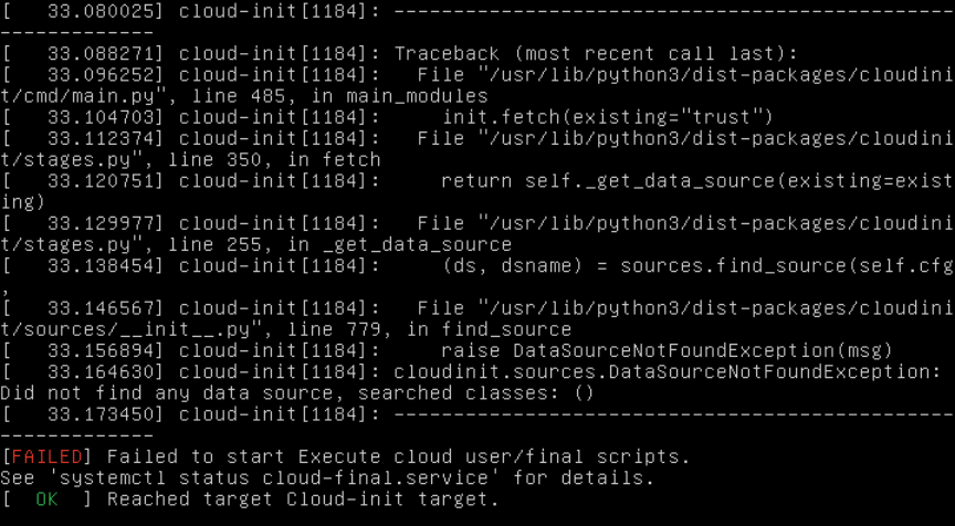

May be related : cloud-init: Did not find any data sources
It appears they had same error, something to do with LXC. Don’t know if this applies to xcp-ng.

It would start the install, get to the very last stage of cloud-init and fail, it skims pretty fast but from what I could see, it couldn’t start openssh. If I press “enter” on the console, it loads up login on the command line. I cannot ssh into it though.
