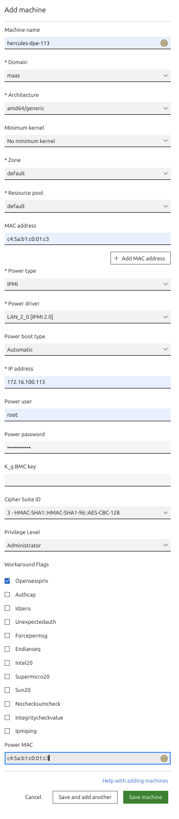

Hi, I cannot commission my dell power edge r250. Some of these settings are a mystery to me.
I 100% have enabled IPMI over LAN in the idrac web ui.
Here are all the possible options. I’m not sure of what workaround flag to use because this is not documented well as well as the cipher suite to use. Also, I am using Automatic albeit the server does advertise it uses UEFI (I think). Lastly, Power MAC field remains a mystery so I set it to the mac of the idrac / bmc.
Any help would be appreciated. When I have seen commissioning work it goes pretty quickly.

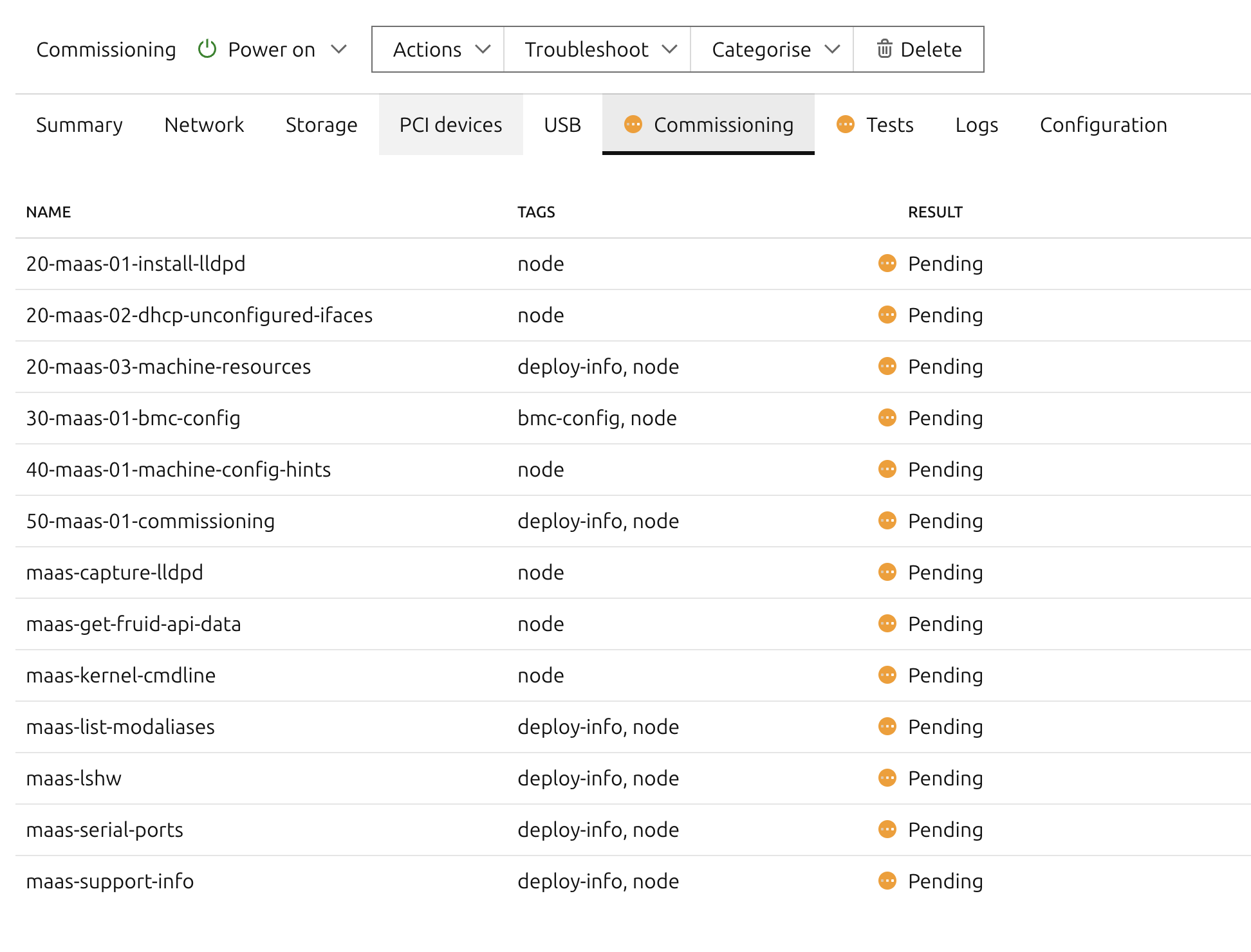

Hi, Troyanov - I actually don’t get any errors it would seem it “begins” the commissioning process and then all tools / tests / scripts hang in “pending” status.
It does show “power status on” after entering the ip / mac / username and password for the IPMI user. I am also able to connect to idrac UI / web interface.
Nonetheless, commissioning does not progress at all. In the past, this has been very fast for machines that did commission.

It looks like on MAAS you are setting the same NIC for both PXE and iDRAC. Have you configured your server to PXE from that NIC? You should change your settings accordingly to do it
Hi, r00ta - I’m not sure what you mean completely. I thought my nic was the bmc nic used for idrac/ipmi?
I don’t know how you wired your server so I can’t really answer. Usually you have a dedicated NIC for iDRAC, and you might want to PXE from one of the others NICs of your server (you must configure the boot order to PXE from that NIC first of all).
Also, you should check in your server if iDRAC is configured to use the dedicated NIC or if it’s using one of the others.
Also, did you configure your iDRAC with the static IP 172.16.100.113?
Once you figure out how your server is wired, you should be able to configure your machine
Hi, r00ta - I have the idrac which has a dedicated NIC and mac address. We also have an ethernet card. It is my assumption then that the power settings are all dedicated to the bmc mac / ip? May I ask the difference between “Power MAC” (is that a mac address?) versus mac?
The idrac is getting the dynamic ip over dhcp from our juniper device.

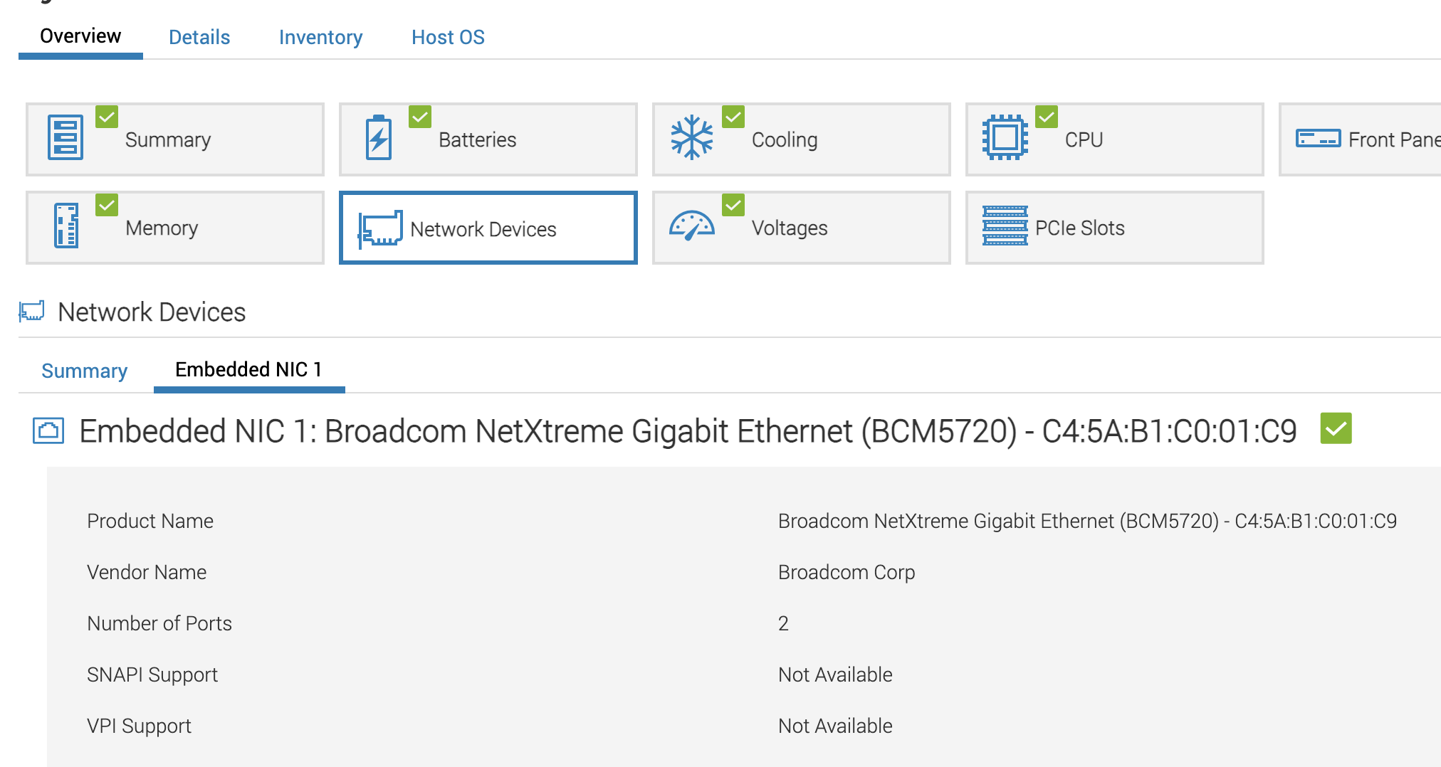

@r00ta - this is a brand new server. Here is the network card:
Also, here is the idrac settings (mac and private ip)
Also, since this server is new we do not have an operating system set nor an ip bound to the main (non bmc) nic. Does this matter? We did enable pxe for nic 1, but we were hoping to turn the server on and commission it and then push an os during commissioning.?
The MAC address of your first NIC is C4:5A:B1:C0:01:C9, but in the first screenshot you sent you are using C4:5A:B1:C0:01:C3.

The C3 MAC is the mac of the bmc/idrac. The C9 is the mac of the ethernet card, but that has no IP when the server is powered because no os.
Also, to clarify - in the first screen shot I thought the first input field for MAC was also for the bmc mac… I guess that is for the pxe nic (not the bmc mac)?
Also, do I need to boot an os for this to work in order to have an ip assigned to the nic of the server?
Yes, it’s for the NIC that is supposed to perform PXE.

The point is that apparently MAAS is able to power on your machine, but the machine is stuck somewhere in the boot process. I’d suggest to look at machines → your machine → logs → events logs to see if the machine is actually asking for the grub and the other files. If you don’t see anything there, it means your machine is not making any PXE. In that case, I’d suggest to double check again the boot order of your machine. If it fails again, I’d suggest to attach your server to a monitor and see what’s happening when the machine boots
Thanks, r00ta - I have done all of this to the T. I think IPMI is blocked somehow.
I just got done trying with PXE as first boot order and same difference.
