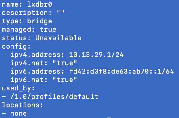

step2: verify that network bridge exists
lxc network show lxdbr0
that should give output such as:
afbeelding

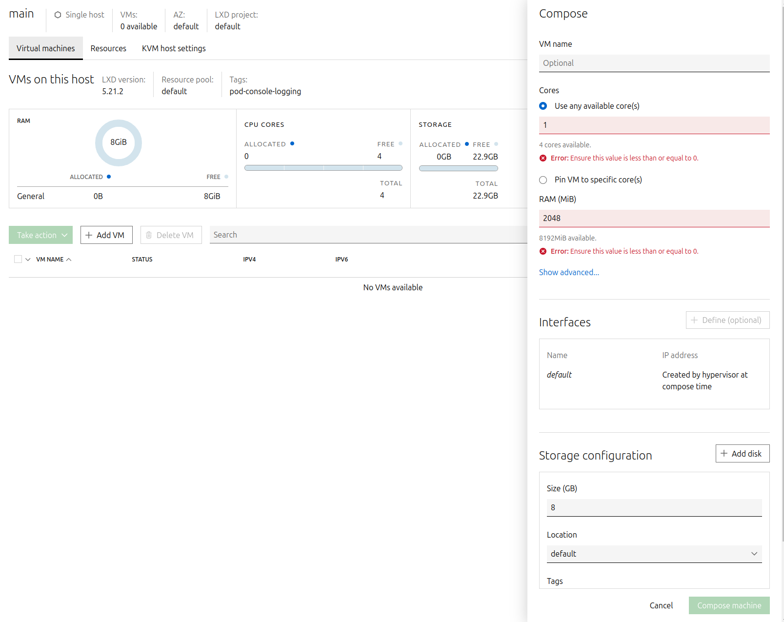

Further to deploying a LXD host with MAAS, does anyone know why it is possible to create a LXD host when Ubuntu 22 LTS image is selected but NOT when the Ubuntu 24 LTS image is selected?
Is LXD host support deprecated with Ubuntu 24 LTS?
