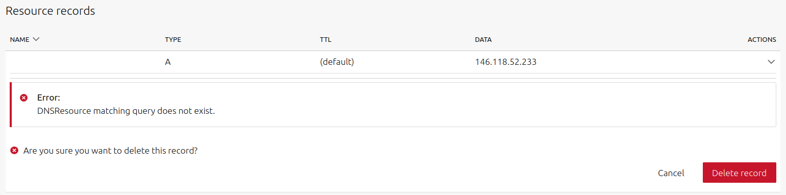

We have found a DNS entry which causes a problem: It has no name value, so from MAAS the whole subdomain resolves to an unwanted IP, while from outside of MAAS it is already configured to resolve correctly. On the region controller:

Notice the space starting the last line - by my reading that is why nimbus.pawsey.org.au resolves to that IP from MAAS. Externally it resolves correctly from upstream DNS to a different IP. At https:/…/MAAS/r/domain/1 (Name: nimbus.pawsey.org.au) I see what I think is the erroneous entry, screenshot attached of me trying to delete it.

I am left wondering if this snuck in quite some time ago (perhaps in an enlistment gone wrong?) in a previous version of MAAS, and in the current version that particular type of record can’t exist, and can’t be deleted. Do I need to dive into the database and delete something manually to fix this?

Any attempt to change or delete it yields sequence item 0: expected str instance, NoneType found. I can’t find any evidence of a machine with that IP address - nothing from arp or nmap either.
