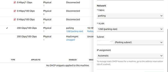

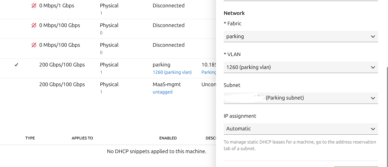

i have tried the same via UI it works fine below is the screenshot
As a next step i will be creating the bond and assign static ip to the bond
