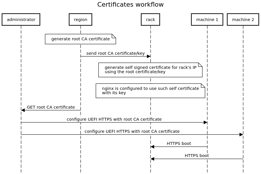

In order to share the workflow we are evaluating with the community you can take a look at this chart
In short, the server would trust only images coming from the server with the certificate that was set in UEFI.
Side note: if a server does not support certificate pinning in UEFI, it’s actually impossible to prevent the machine from loading a malicious image from a malicious DHCP server.

Unfortunately this is not going to solve your security problem at all. An attacker could easily bypass all the kind of security checks you would run in the rack to try to detect a malicious DHCP server on the network. PXE is not secure by design and IMO this is not the right way to tackle your scenario (which is 100% legit).
As I said, the right solution for this scenario is to use HTTPS boot with trusted certificates.
