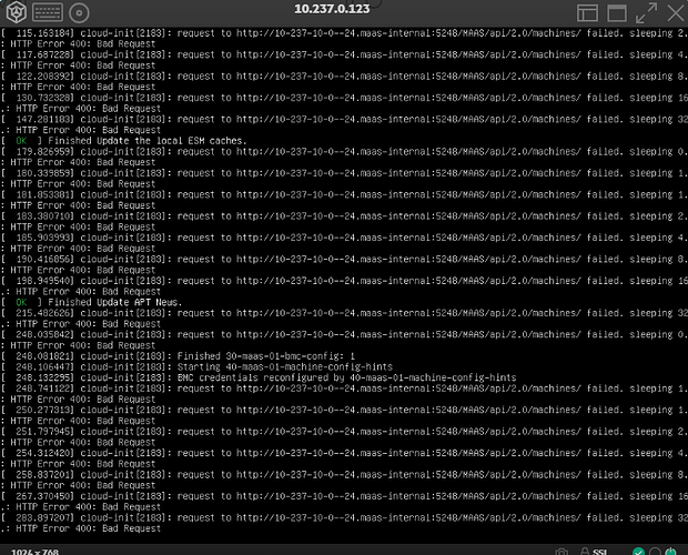

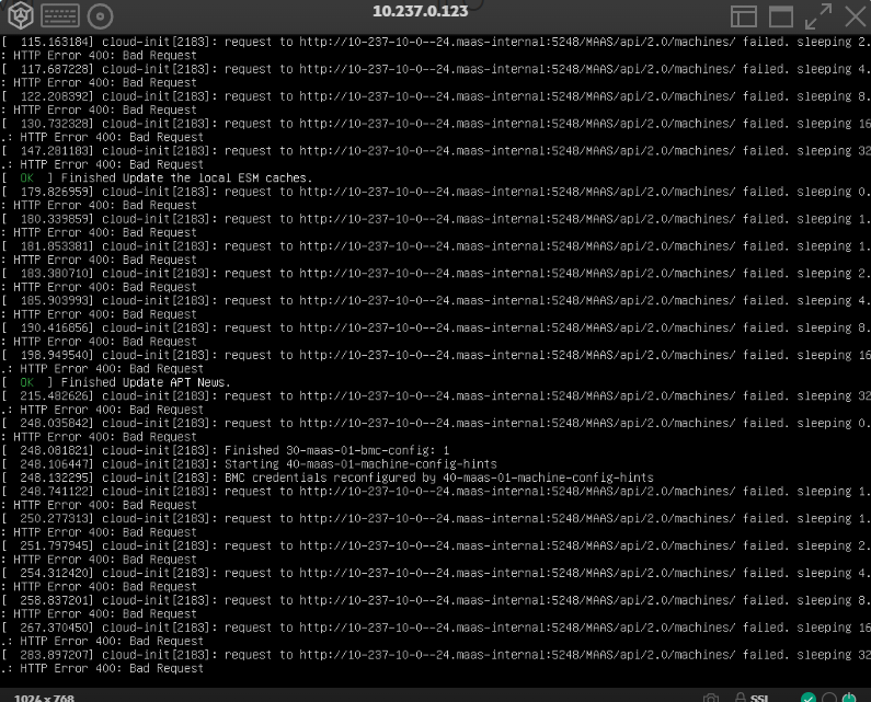

We have a lab installation where some (suspected) schema corruption going from 3.4->3.7 prompted us to look into building a new controller/db. We tried adding existing hosts as “devices” with the mac, static ip, and hostname but found they were still being served discovery images. You can declare a deployed-state machine object, but not MACs and IPs (since its deployed), so no A records and MaaS will still try to discover it as well. Nor do we want a bunch of stub records forever stuck in “new” state. We figured the point of a device object was to generate a resolvable A-rec and not attempt discovery, but it seems to try and fail anyway (pictured). Meaning we have to just manually register A records and hope that none of our machines netboot :frowning:
